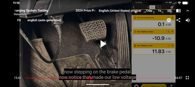

    You can see in this WebAuto youtube video that as soon as he powers on the Prius Prime current begins to flow into the auxiliary battery from the traction battery.

    Backing that video up seven seconds before where you set it to start, you can see that he steps on the brake pedal first and then presses the power button. Reviewing the choices from #7 above, that puts the car in READY.
    • OFF
    • ACCessory (one button push, no brake)
    • ON (another button push, no brake)
    • READY (button push with brake)
    He said "on" but that's just a matter of misspeaking. He definitely put the car in READY, which is the only choice that will keep the 12-volt battery charged. ACC will discharge the 12-volt battery, and ON will discharge it even faster (because more of the car's electrical loads are being powered).
