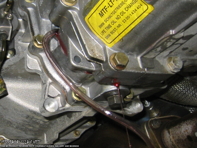

    Sometimes manufacturers claim a lifetime service interval on fluids to give the appearance of their products being less maintenance intensive. BMW did this back in the late 90s/early 2000s with their transmission and differential service intervals. They claimed "lifetime" fluid and put "lifetime" stickers on the transmission and differential cases. These same exact transmissions and differentials including the fluid were just 60,000 mile items the year before. This change was implemented as part of a marketing campaign to drive more people into BMW dealers in order to challenge the perception that BMWs were maintenance intensive. There are many BMW automatics that go 200k and beyond on the original fluid but if it were me, I'd change it well before.
    In the case of the Prius, you're probably fine using it for a lifetime. It doesn't cost much to change though and I'd just do it.
