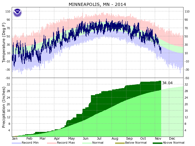

    Out of curiosity though I looked up weather data for Minneapolis. Median HHD for January is about 1600 starting from 65F which means average 24 hour temps are about 10 - 15F. This about matches this graph, grabbed from a NOAA website. An area that routinely stayed below 0F would have around 2000 HDD in a month. Fairbanks AK averages 2400 HDD in January and reached 3000 one year. I feel cold just reading about it.
