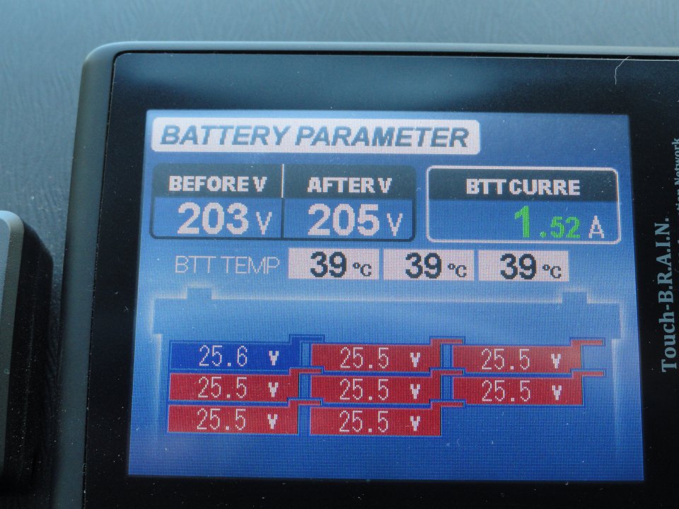

  16. RightOnTime
    RightOnTime Senior Member
    Sep 21, 2012
    791
    1,660
    183
    Kidnapped in OC, CA
    Yes, there are many JDM monitoring systems that can put the Scangauge and Torque to shame!
    Here is one of many screen grabs of my Blitz T.O.U.C.H.
    There are so many options that i can monitor, which then gives me a clear picture of how hard my car is working.
    Tracksyde and markabele like this.

  18. markabele
    Mar 27, 2012
    5,084
    1,782
    Nebraska
    If I remember correctly there are 3 battery temp sensors. The middle one seems to be a good average of the other two. Just a basic log of battery temp along with what the car is/has been doing (and a few other pertinent details) would be really beneficial I think. This could put to rest our friend's liquid cooling system as overkill debate. :)
