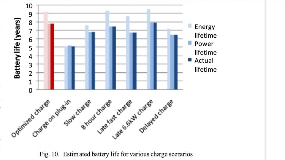

    Sure, but I believe the first graph, "Impact of temperature on battery in a parked car", is based on yearly average as well as peak temperatures (Phoenix 27C or 80.6F average).
    This is why Nissan LEAF batteries have been degrading rapidly in Arizona and other hot climates. Even in moderate areas like the greater San Francisco Bay Area have seen 15% loss of range in 3 year old LEAF cars with 30,000+ miles. PiP will do better because of a more tolerant chemistry and cooling fans (of which the LEAF has none).
    I'm not saying the PiP battery is going to shrivel up in the sun and turn into a Lithium electrolyte-filled raisin. I'm just saying that cabin temperatures that feel hot to humans are likely contributing to somewhat faster battery aging in the PiP battery and should be minimized or avoided when it's not too much effort. Just basic common sense.

    Not really. If you read the threads at the LEAF forum the consensus is that charge levels and quick DC charging have only a modest effect. Most of the degradation is associated with average climate temperatures, calendar aging, and miles driven. They have developed a battery aging model in a spreadsheet. You can apparently enter those parameters and it will predict your LEAF battery energy capacity reduction. I haven't tried playing with it yet.
    I see posts there from people in moderate climates with primarily 80% charging, 2-3 years of use, and 20,000+ miles who have 10-15% battery loss.
    The "lifetime" shown typically assume 20% degradation of either power or energy capacity loss. That's an arbitrary battery industry convention.
    Actual battery warranties are often vague about capacity loss or fail to warrant it at all. I'm not aware that CARB requires any capacity loss warranty coverage. It does presumably require that the batteries can still operate the car.
    The Prius is well-suited for having the engine seamlessly step in to offset any reduced power or EV range reduction so the PiP battery pack will presumably last the life of the car without actually needing replacement.
    I've got a bunch of battery papers from various research groups stored on my phone that I skimmed through the other day to find those graphs.
    The same basic graphs and data show up in many of these papers and slide decks. I failed to take notes on which slides came from which documents but 2 of the 3 came from recent reports published by NREL which is one of the US national laboratories.
    Here is their publications page:
    NREL: Energy Storage - Publications and Presentations
    Here is a paper with very relevant things to say about NCA cells, the Prius, and a PHEV 10 model that represents a simplified PiP. Also, a slide deck about battery degradation.
