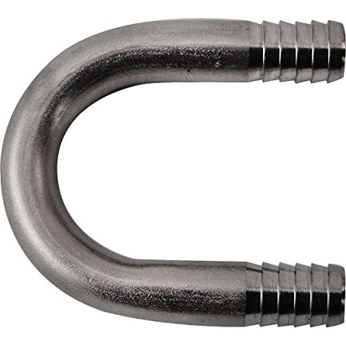

    Depending on what threads those hose barbs have you may be able to do something like:
    OR
  14. Mendel Leisk

    Any straight hose will collapse if bent too much unless it is molded that way. I have seen hoses use springs inside or out to apply pressure on the walls to prevent collapse. Jegs <-------- click
    Screen Shot 2018-01-10 at 8.04.10 PM.png Screen Shot 2018-01-10 at 8.04.33 PM.png
    leeb18c likes this.
