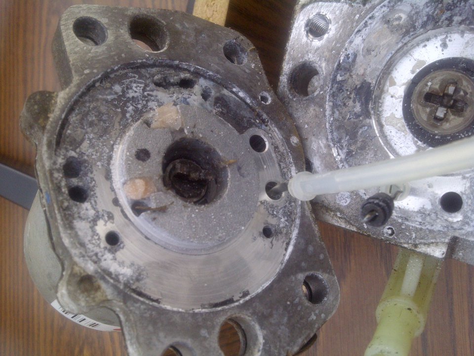

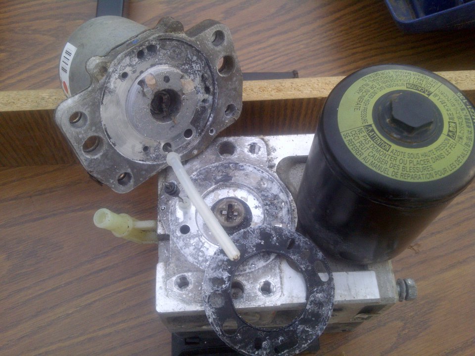

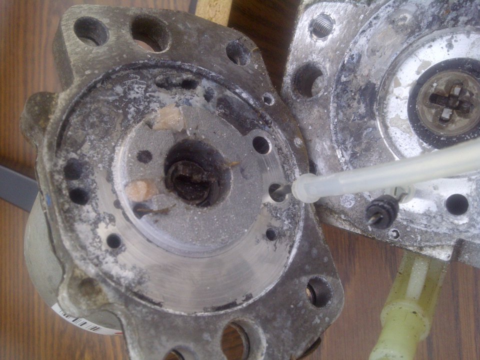

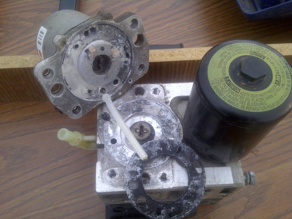

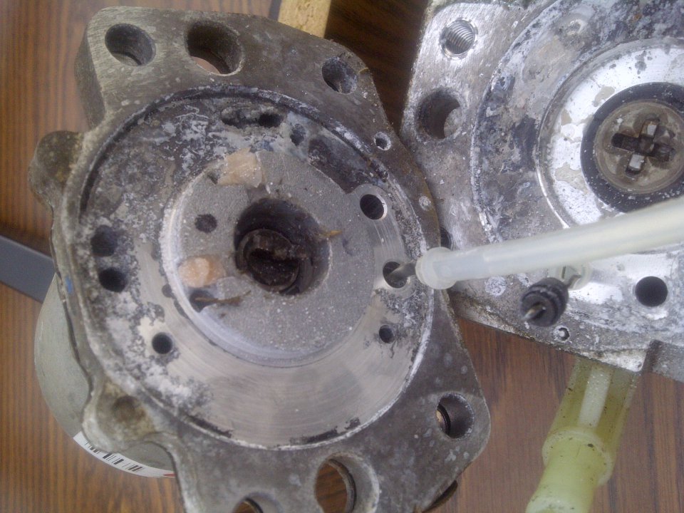

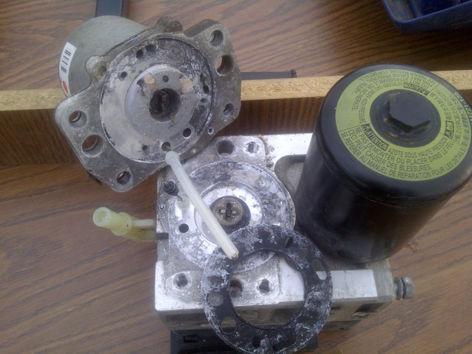

    Hi Patrick,
    Used part was $150 CAD and works perfectly. Did not replace the resistor and there is no difference in noise level.
    Wanted to add that I partly dismantled the thing and took some pictures...
    As you can see the part is not in good shape and is hard to rotate with a metal to metal noise. If someone has any info on what can cause this and what this part does feel free to add your comments! At first sight, I would say a bad seal.
  3. emanboulay
    emanboulay Junior Member
    Apr 21, 2009
    So no comments on what that specific part does and why it is in bad shape? Just curious. Take care!
