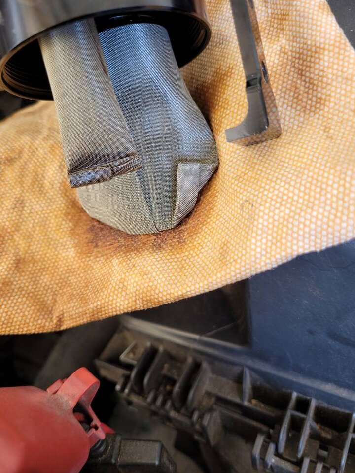

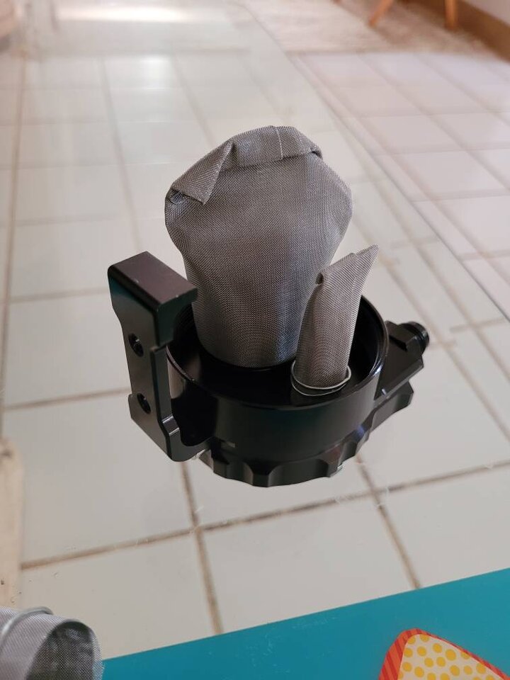

    Not if you use the stainless steel potscubbers.
    In addition to the SS potscrubbers, I made filter screens out of multiple layers of a fine mesh stainless steel. It acts like an oil saturated gauze filter (like K&N) to condense out the vaporized oil in the PCV circuit on its way to the intake manifold.
    There is still oil that gets through to pool in the intake, under the throttle body, and the inside of the hose attached to the intake manifold is coated in oil as well. 20211202_114442.jpg 20211109_112505.jpg

    You a magician? What’s holding your media in the second pic...

    looks like the oil catch can top cap…
    I did a cleaning on the intake manifold since I had the occ and there wasn’t any pooling of oil behind the throttle body plate under the intake manifold.
