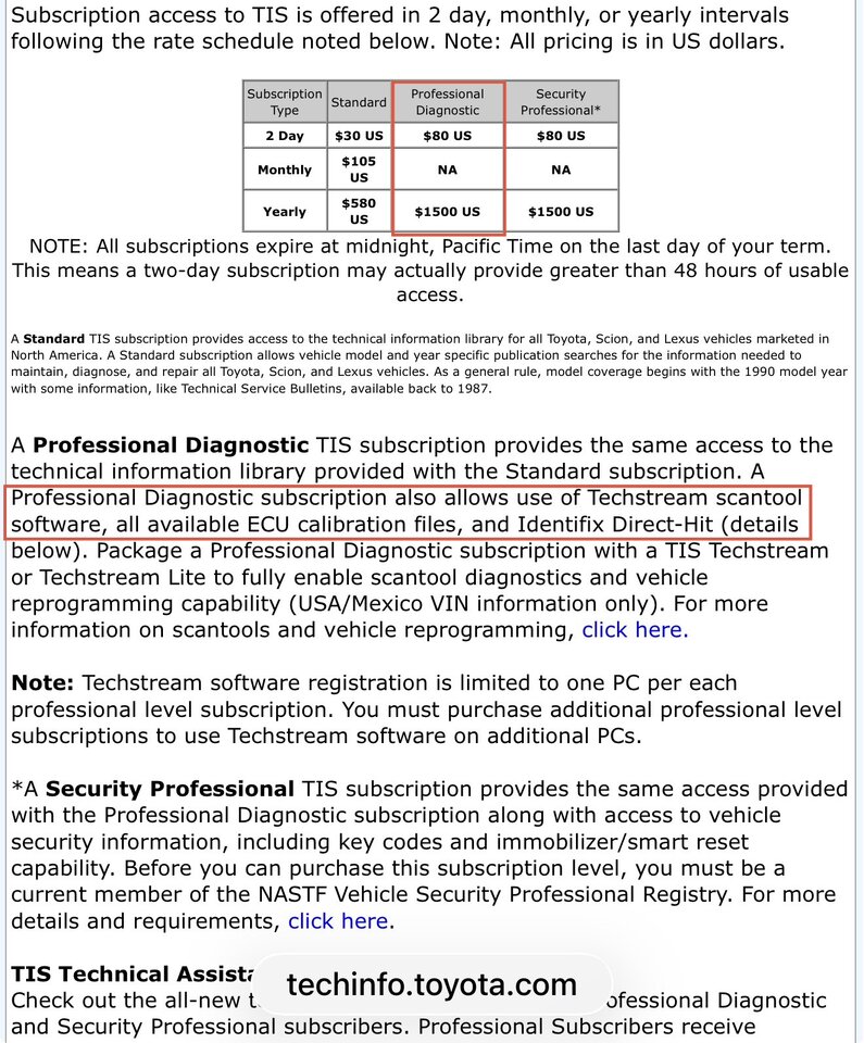

    Where would I get the software update file?

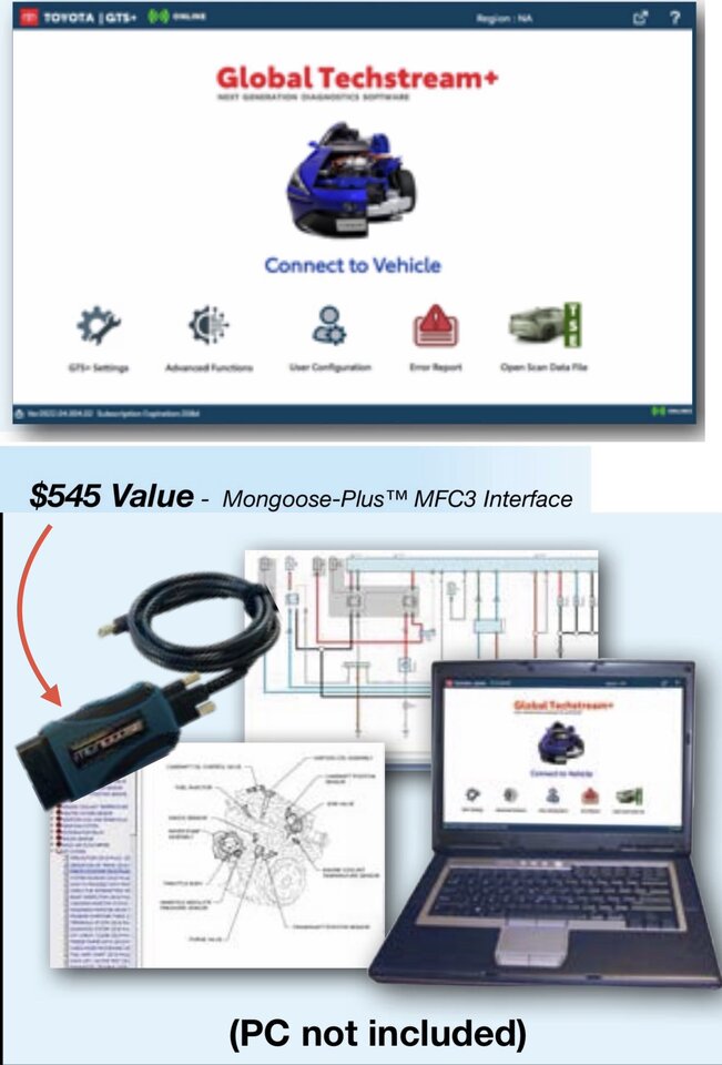

    For an ecm update you need to buy access to the Toyota TIS system and have the latest Toyota Scanner software running on a PC with a hardwired Mongoose usb to obd2 interface. Its cheaper and safer to let Toyota do it. I would not worry about it until you have a trouble free engine. Then consider updating the ecm software.
    Latest Global Techstream+ required along with a $545 Mongoose interface. You supply an adequate Win11 pc.
    Global Techstream+ download and two days authorization is $80. Includes calibration files for updating your ecm or other ecus.
    Better to let the dealer do it unless you are a shop with continuing requirements of this kind.
