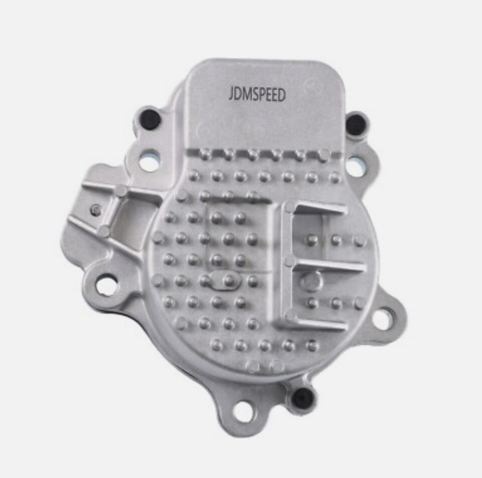

    They have processed my refund but have not requested to return the product yet .
    Does anyone have photos of a WPT-190 from Aisin? Not stock photos from online, something verifiable here. Detailed photos so I can compare. It could be a repackaged Aisin pump, the OEM Toyota branded Aisin pumps seem to have much more markings and such on them.

    I am almost positive I now have a free water pump, to set things straight this was never my intention...I was fully ready to send the pump back even if I had to pay some of the shipping. But to get a full refund and not expect the product to be sent back....kinda says everything there is to know about who is selling these and what they are really selling. Their english is bad enough that I was confused as to why I was refunded before the part was returned. I do understand that returning and restocking sometimes costs more than the product itself and sellers will chalk it up as a loss just to maintain good public relations. I am in no way trying to label myself as a scammer, nor do I want that title...

    Generally overseas sellers don't want them back. Was the ebay pump $115 including the thermostat?

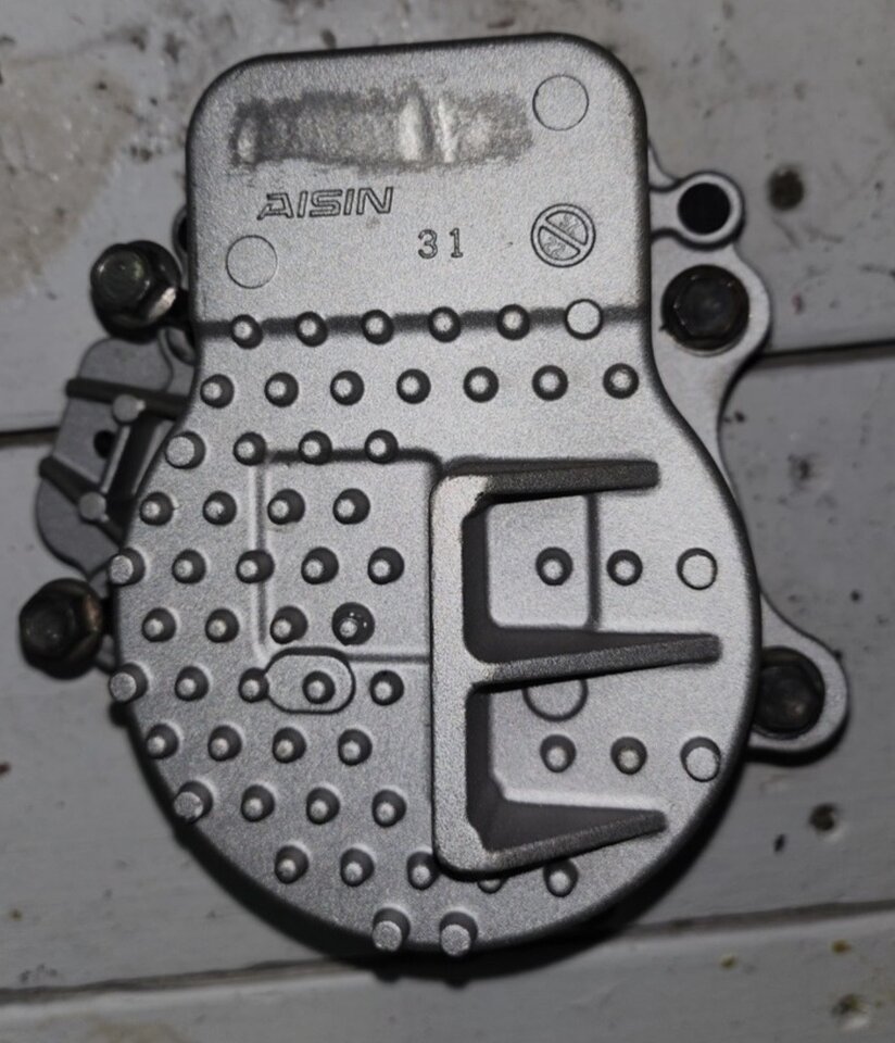

    Counterfeits can look very good these days. The front pic you posted looks exact, however the prior "genuine" direct Aisin units had the Toyota logo ground off.
    There are aftermarket units that make no bones about being copies. This brand also makes an egr valve with known different internals.

    There was no thermostat, I bought it separately from a different seller. So is this picture a genuine Aisin or a copy? Are there barcodes, QR, and SN on the Aisin ones housing?

    The pic with the ground off Toyota logo was Aisin. Lots of good long term reports on that one. Not so good on other counterfeits.
    You won't find Toyota parts with QR codes, barcodes or serial numbers.

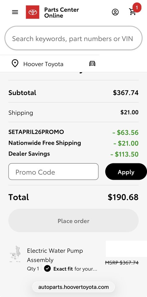

    Most of us like reliability and buy critical parts like this from Toyota. Most aftermarket parts for Toyota are not as good by a large measure.
    I would buy from a Toyota dealer online. Current April 8, 2026 total price $191.

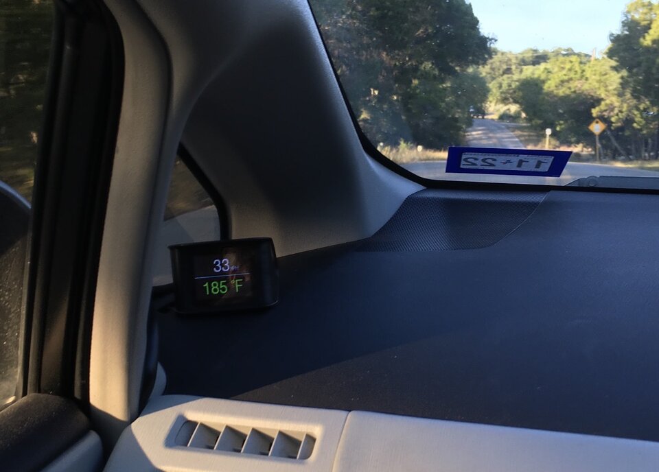

    Toyota electric water pumps last a long time with proper coolant changes. I have over 300k miles on mine. Ten coolant changes, 5k oil changes and two egr "cleanings".
    I monitor my coolant temperature because the factory, no audible, dash light may be missed and has been reported to blink on and off once if coolant has been lost.
    I use an audible alarm at 220f so I don't have to watch it. My wife normally drives the car and would hear it before it reaches 248f (the normal warning temp with no pump codes). Then I would hear about it one minute later.
    P10 Obd2 Display ~$30
    Just having it for years allows me to know normal. In Central Texas at highway speeds normal is about 195f. Worse case up a very steep hill for a half mile its 204f and falls back in seconds when back to level.
    There is no guessing. Have not needed it yet.

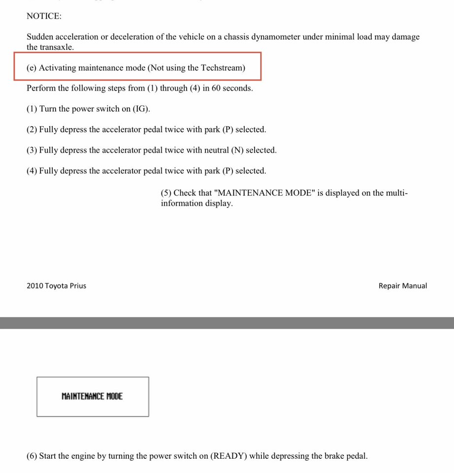

    Three is certification mode which is pointed out in the manual.

    I think you're right, there's one that says two, and the following says three. The repair manual formatting is very confusing though, hard to tell which is which.

    Earlier generations had just one inspection mode, which combined the effect of keeping the engine running (for purposes like emission testing and adjustments) and inhibiting traction control (for purposes like dyno testing).
    Gen 3 split that into two modes, "maintenance mode" (like the old mode), and "certification mode" (only inhibits traction control). Maybe not a perfectly clean split, as the summary chart on the first page for the procedure makes it look like "maintenance mode" still does both of the old things.
    Anyway, "maintenance mode" is the two-stomp mode, and "certification mode" is the three-stomp mode.

    Part of the problem is understanding the purpose of the two modes and then choosing the right one. In the referenced pdf it is not clear Maintenance Mode can be used to warm up the engine with a constant idle.
    The condensed version is also confusing about shifting to and from Park and Neutral before or during the gas pedal operations.
    And then the critical sixth step is on the next page. So we have the procedure at least times in this thread alone but one is wrong. Best two out of three?
