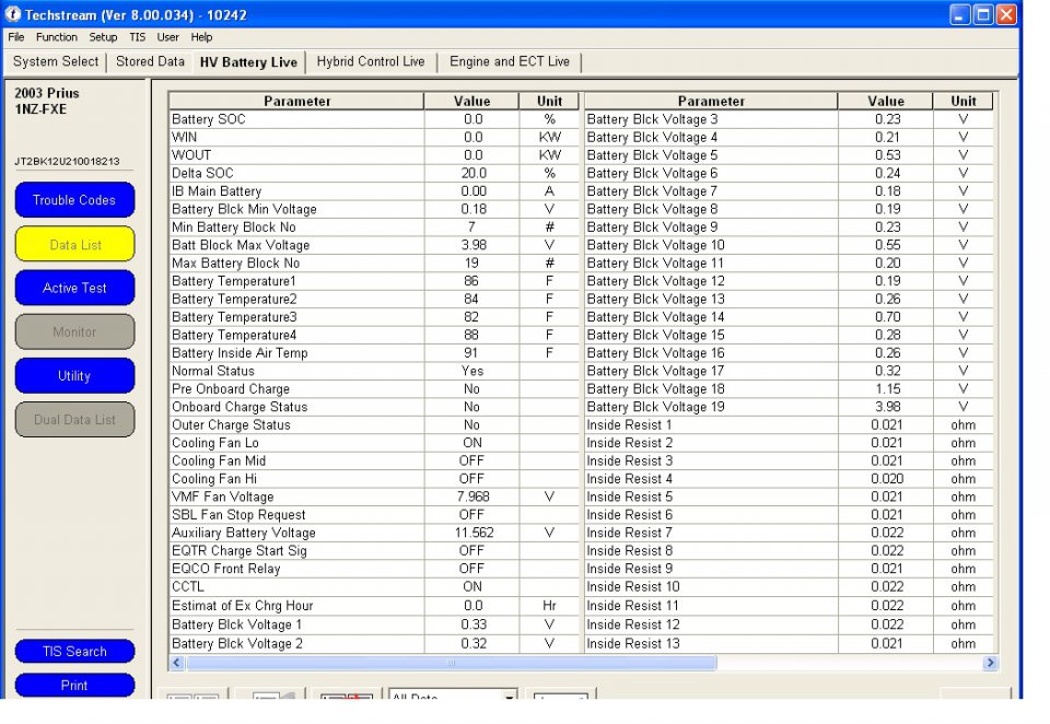

    Heres a picture i pulled from techstream, this is the current state of the battery. I confirmed this with a multimeter.

    wow, i would say that battery is pronounced dead at the scene. i dont even think i would try to cycle any of those to see if they come back.

    It is interesting that the 13 battery resistances shown are about equal in value and in normal range. I would think that you would see an abnormal resistance value in the possible bad modules.

    your highest voltage was 3.98 and your minimum was .18. you can try to charge the best one and the worst one. if they come back to life then try charging all of them. wouldnt hurt to try.
