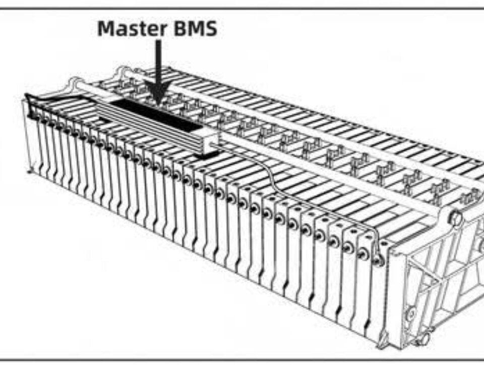

    They are clearly attacking the last company who tried to retrofit lithium in place of niMh. Primarily stating the Toyota bms will overcharge aftermarket lithium modules and create reliability and safety issues.
    The marketing shows their new "master bms" measuring from one end of the assembly to the other end.

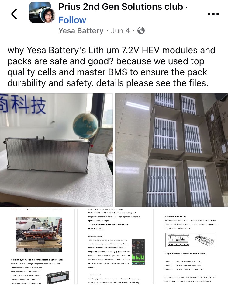

    The facebook "file" description states "It monitors pack voltage/current in real-time and intervenes (e.g., disconnecting or limiting) to prevent the vehicle's charger from pushing lithium cells beyond safe limits".
    The "Master BMS" mounts on top of the modules with thermal paste between.
    Nothing references individual module or cell monitoring.

    In my opinion, the topology you describe – combined with the picture you posted from their Facebook – could not possibly provide the per-cell supervisory control required to safely operate lithium cells in a vehicle originally designed for NiMH.
    For legal reasons, I cannot definitely state that as fact without physically examining the product.
    However, in my opinion, this is not a safe pack for NiMH vehicles.
    I would ask the manufacturer "How does the pictured topology disconnect or limit the vehicle's OEM electronics from over-charging/discharging the cells? " If the 'BMS' were placed in series with either (or both) HVDC cables, then maybe it could fault open as needed. However, that safety topology would assert the CEL whenever it activated, which isn't a great user experience.

    Hold me back it's a Facebook marketplace listing. Pass me to popcorn
  10. rjparker
    rjparker Tu Humilde Sirviente
    Jun 6, 2008
    11,135
    6,984
    Texas Hill Country
    That's right but people will fall for it and send money. It even happens here on Priuschat.
