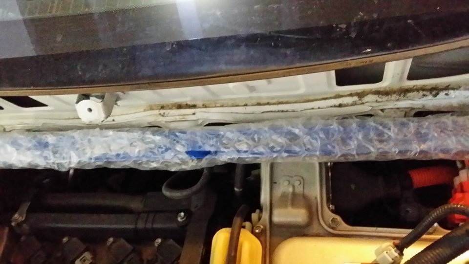

    After looking carefully at your pictures, my brackets are definitely almost identical to yours, but there is no way my cowl pan will go back in like that.
    I wonder if there could be a difference in the 04 vs 08? Maybe they made the Cowl pan deeper?
    Anyone know?
    Do you suppose you could do me a favor and take a pic of what the bar looks like under the cowl? Might be hard to get, but if your cam has a Macro setting it might work. This way I can see if there is a difference.

    As an inside information for the install, I had the same problem you described; my solution was to bend downward the towers bracket, where I circled in the pictures.
    The flat bar of the tower's link, barely clears the cowl but it laid flat just atop.
    Once the cowl is installed, I can't see the Strut's bar.
    Also, there is no difference in the body panels in between MY 2004 -2009.

    I had the same problem, I resorted to a little panel beating of the cowl, followed by some mastic to ensure it was watertight. I am glad I persevered it has transformed the ride especially high side winds on motorway (freeway to some) and slow sharp bends

    As for the strut bar, is there any rubbing issues against the wire bundle(passenger side), bracket for the electric motor and the foam under the cowl plate? I am still tossing up on this as there is not much room under the plastic plate and clearance may be an issue.

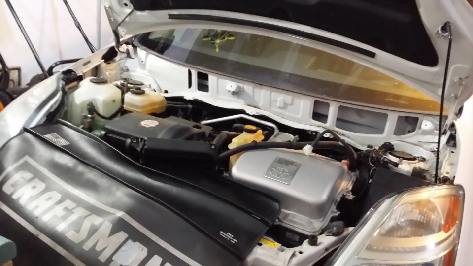

    Going to be trying this tonight. Wish me luck,I'm using a brace for a Corolla I got off ebay.

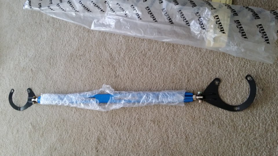

    Fail... Poor fitment. There was no way I could make this fit without hitting the crowl. You would have to cut the crowl and some tabs off. The bolts matched up but could not make it fit no matter what way I turned the brackets or bar. The ebay auction was titled "MEGAN RACING FRONT UPPER STRUT TOWER BAR 03-06 TOYOTA COROLLA E120 2ZZ 1ZZ ALL" I plan on reselling it on ebay because it would not be worth returning for a restocking fee and shipping.

    This is one situation that I'd recommend the Tanabe;

    looks like the same one the op used. did you try flipping it over and adding washers under the brackets like he did?

    No, the Tanabe is a perfect fit for the Gen II Prius. No modifications are needed.
    To me, the money that you'd save on one that needs to be modified is NOT a savings, given the aggravation and time spent getting it to fit, if it is even at all possible.

    As you can see in the pictures the Corolla brace had a good fitment with a little extra work. At that time I saved a bunch of money with the aftermarket, don't regret it.

    Flipped it every way possible including the brackets and angling the bar. Washers would have made it go further up into the crowl. Tanabe has been ordered. Lots of people were out on amazon so ended up getting from ebay.
