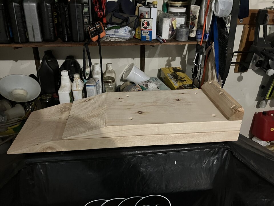

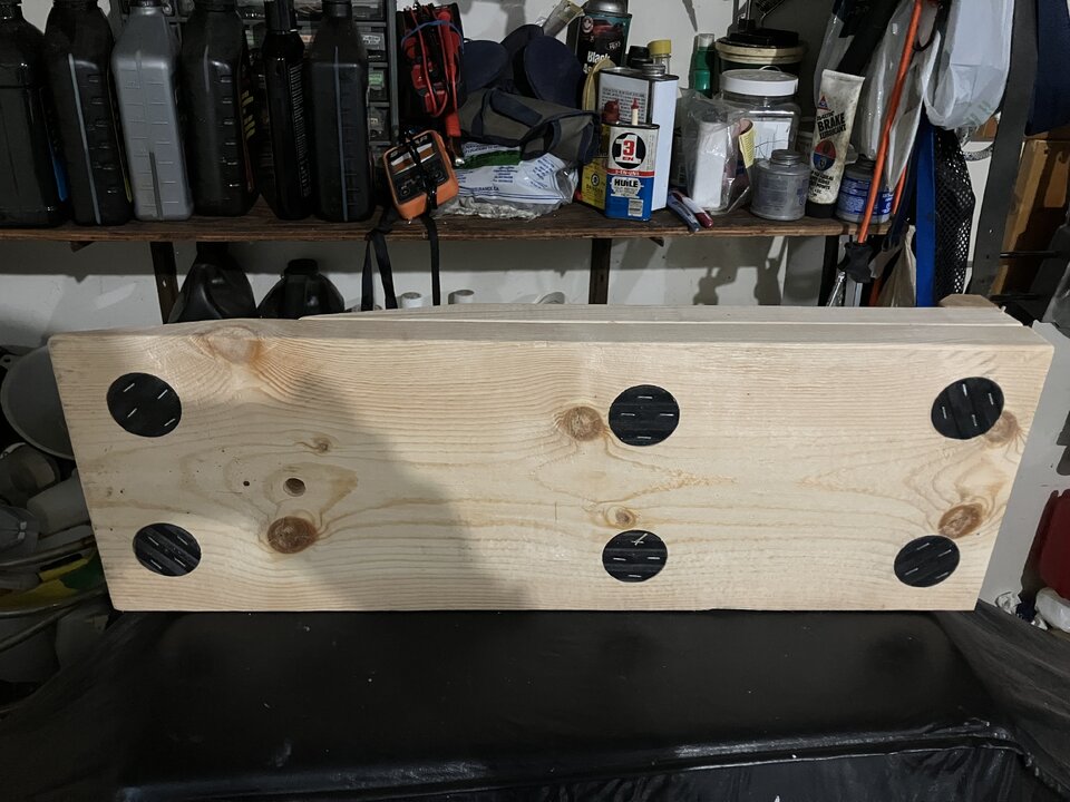

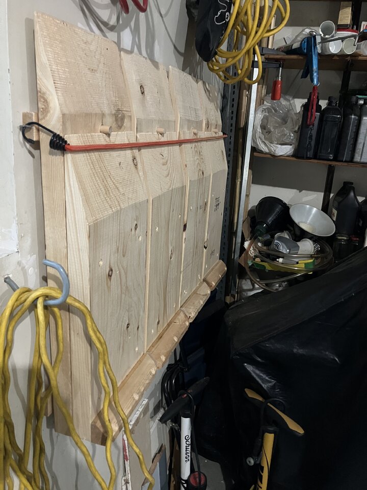

  2. Mendel Leisk
    61,544
    42,352
    Sweet. You have a lathe? Put chamfers on those 2x10's?
    A fellow cobbler. What I've been working on in the last month, not sure I'm done..., maybe I'm never done:
    The rubber coasters on the underside are recessed slightly, in Forstner bit pockets.
    Templeton likes this.
