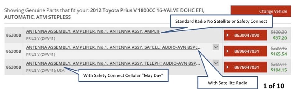

    The screw on antenna is the same for all trims and options. It's cheap enough to buy from the dealer. The antenna preamp is the piece the mast screws into. The preamp has different part numbers and costs based on xm radio or emergency sos service.

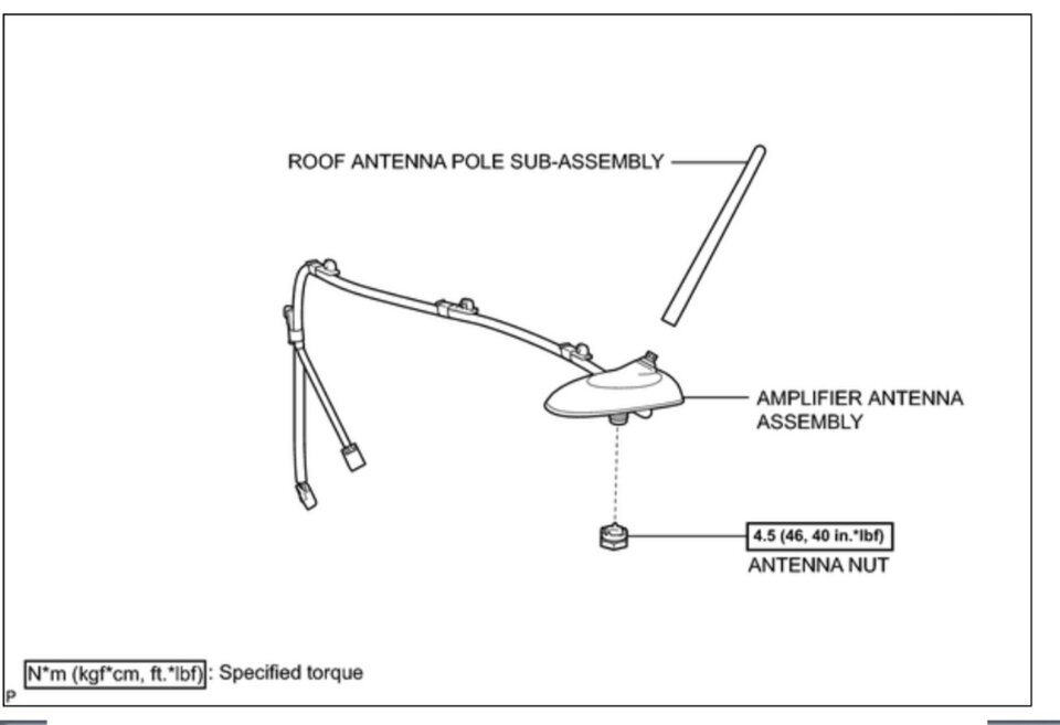

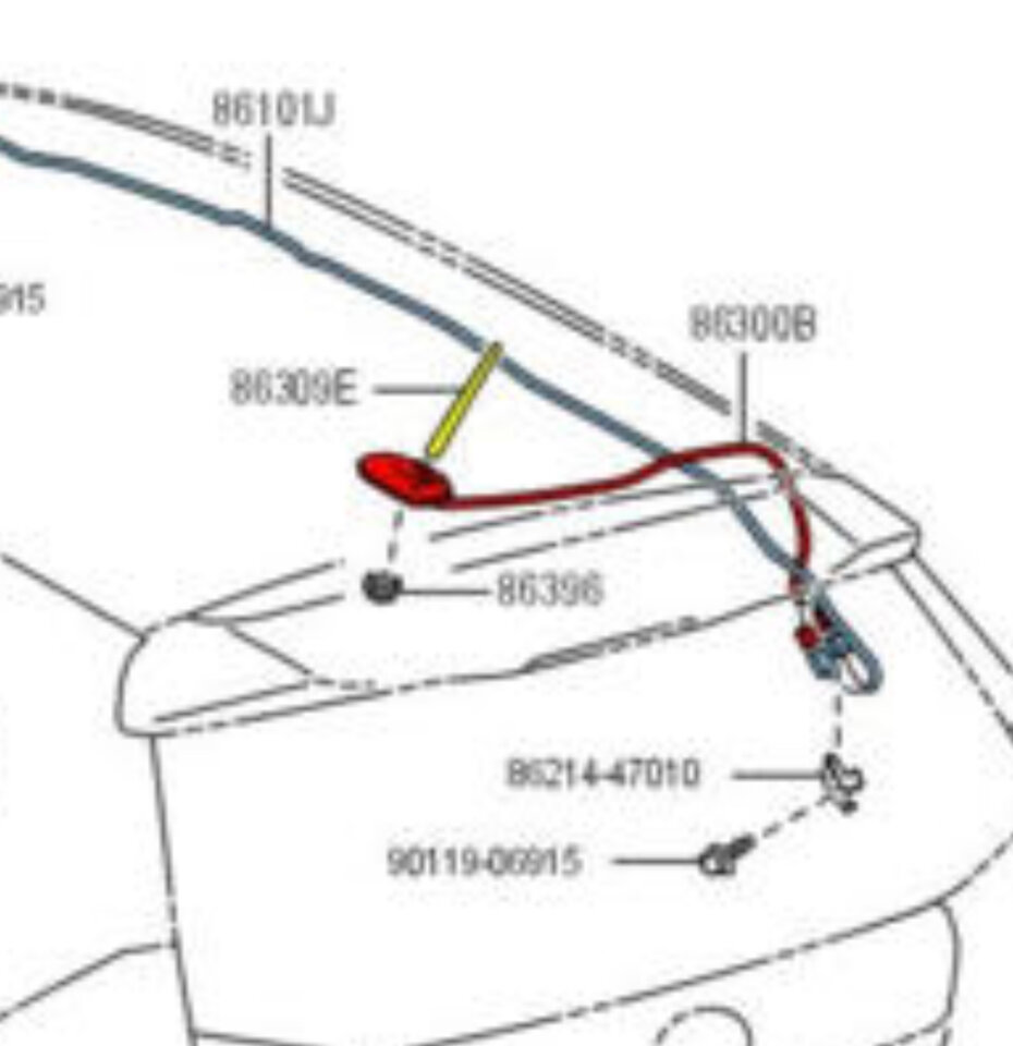

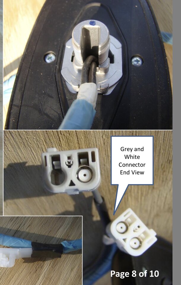

    Does anyone have a service manual for replacing the amplifier portion? Really on just how to remove the ceiling liner to get access to the bolt and cable anchors/connectors. We'll be getting a v shortly that had its base damaged.

    See attached. Note there are three versions of the amp depending on options. Verify specific pn with dealer based on vin.

    More extensive than I would have guessed. Will all the fasteners essentially "pop" out with reasonable force or do I need special trim tools for some of those noted on page 10?

    They will come out easier with cheap plastic trim tools. There are some screws noted on the drawing.
    It took me maybe two hours.
    It could be worse. The manual says remove the headliner which requires removing the windshield.

    Attached a pic of the housing broken off and you can see the bottom of the antenna stud up in there. The whip itself is still attached to it.

    Yes its unlikely that will glue back on and work.
    GPS or Bluetooth is not in this antenna.

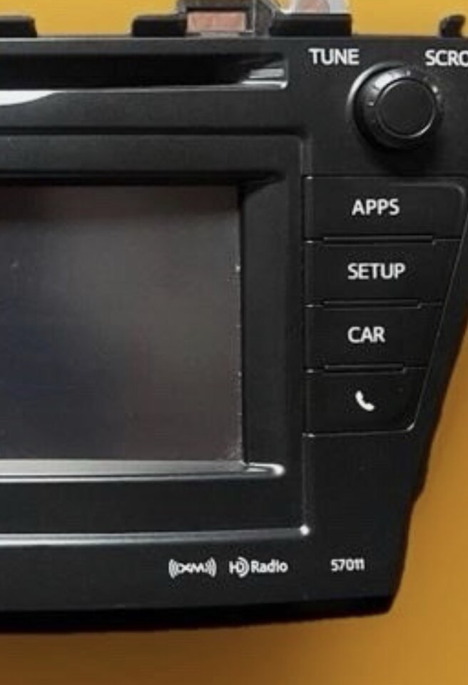

    The radio model is on the front of the radio right bottom. Most are 57011.
    Sharing the year would help. 2015-17 Prius v's were a refresh.

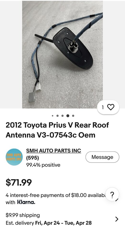

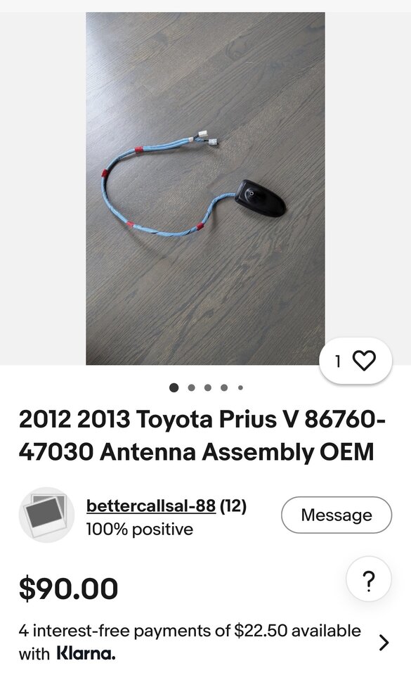

    Any of the attached would probably work for am fm alone but the $39 is one cable only. The $71 and $90 options are what you have if the radio is a 57011 with xm and hd fm.
