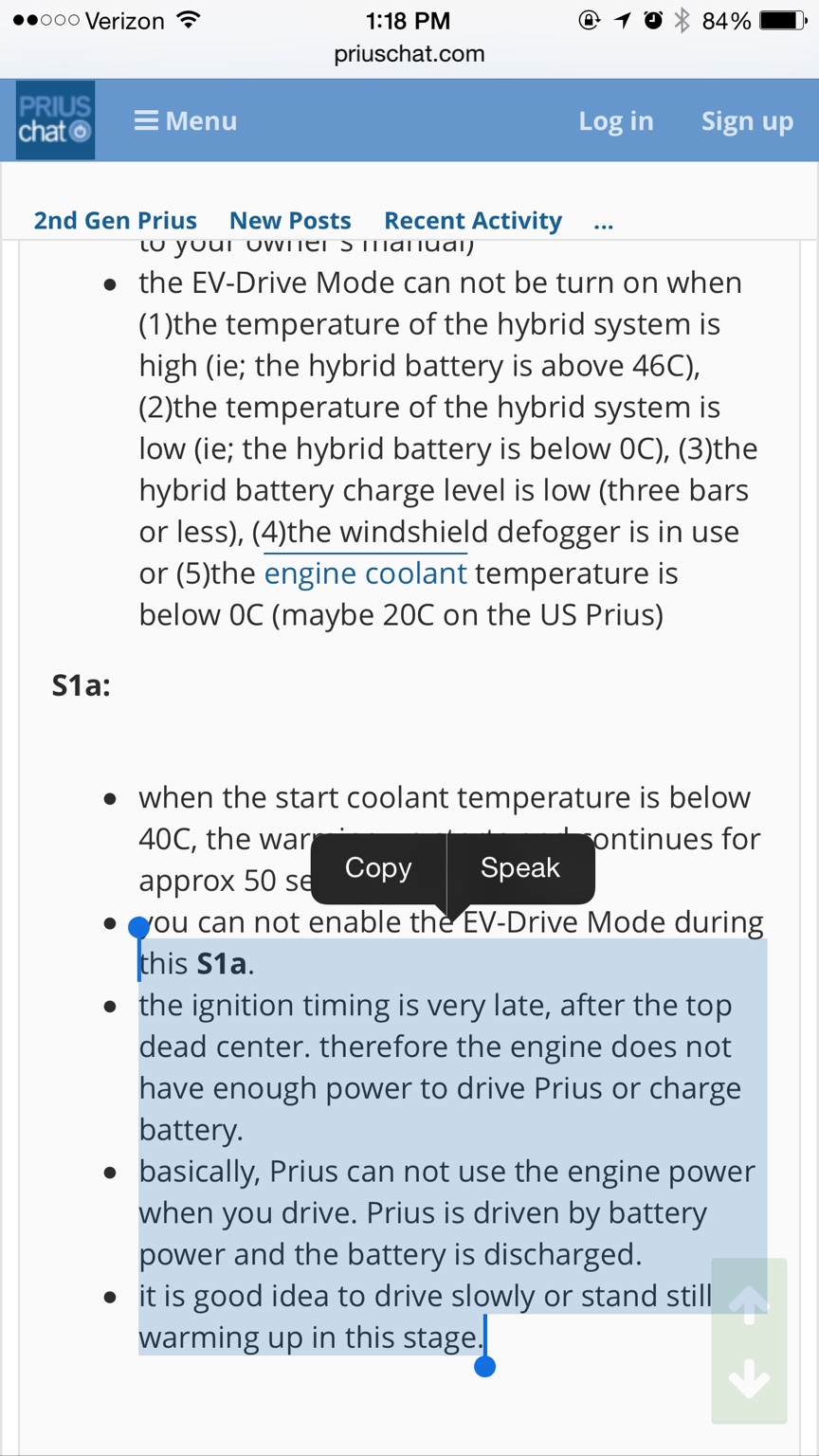

    Start quote:
    "the ignition timing is very late, after the top dead center. therefore the engine does not have enough power to drive Prius or charge battery.
    basically, Prius can not use the engine power when you drive. Prius is driven by battery power and the battery is discharged.
    it is good idea to drive slowly or stand still warming up in this stage."
    End quote.
    Source:
    Gen3 warming up stages | PriusChat
    Sent *from my +Turn off signatures in Tapatalk *Tapatalk*
  13. Tracksyde
    Tracksyde Member
    Sep 21, 2011
    1,429
    762
    So Cal
    But you still have the cooling effect of air passing through the engine compartment.
    I would agree that moving with the ICE running could be more advantageous to sitting stationary while warming up, but only under the condition that the ICE is under load. My first few miles leaving home is mostly downhill and lower speeds. Warm up time is definitely longer if I'm cruising down the hill versus just sitting in the my driveway warming up. With any juice left in the battery and driving in ECO, putting load on the ICE requires a decent amount of pedal pressure.
    The issue with getting 0 MPG versus, say 10 or 20 MPH while moving is purely a function of you moving (miles). You're not consuming any more gas while sitting stationary with the ICE running (during warmup) versus moving (you're actually most definitely using less gas). But whether you put that extra gas to use (under load) to warm up the engine faster is the difference.
    From my own anecdotal evidence, FWIW, allowing the ICE to come on when it needs to and parking in my driveway versus me starting the ICE at a stop light (usually with about 1-2mi of EV left) is the difference, for me, of about ~160 MPG versus ~180 MPG over a 13 mile drive from work to home and a net gain of 600ft of elevation. Splitting hairs, I know.. but hey, thats what we do here, right? :D
  14. mmmodem
    mmmodem Senior Taste Tester
    Nov 17, 2011
    2,732
    1,703
    Bay Area, CA
    Interesting read. (y) I stand corrected. Idle 50 seconds after start up before moving for best fuel economy. Although, reading all 5 pages, not everyone is convinced this actually provides the best fuel economy. Only way is to test it. It probably won't be an improvement for me as my work and driveway are all on inclines so that I will be coasting longer than 50 seconds by the time I need acceleration. That and I have a PiP so warm up can happen anywhere.
