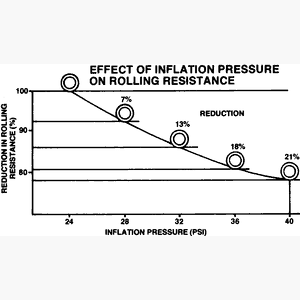

    This is excellent. Thanks for posting this, friendlyjacek. This agrees with the rolling resistance test results posted earlier that showed diminishing returns around 40-45 PSI. Of course there will be different efficiency curves based on the type of tire and vehicle, but this further supports my emerging opinion that it's probably not helpful to inflate tires above this general level and that hypermilers are looking for efficiency in the wrong place.
    The Transportation Research Board study that your guy quotes also says that:
    "Rolling resistance, therefore, directly consumes a small
    portion (4 to 7 percent) of the total energy expended by the vehicle."
    And as the report also points out, since tire pressure is only one of many variables that is correlated to rolling resistance and the PSI/Rolling Resistance curve is not linear, it seems that you're going to get very little MPG improvements by over-inflating tires.

  7. fuzzy1
    17,917
    10,701
    Mathematically speaking, diminishing returns happens everywhere along that curve. Any point of apparent flattening is in the eye of the beholder, and can be moved to any arbitrary location by changing the graph scaling.
    This is a value judgement, a compromise between competing factors, and you can speak only for yourself as to the value of the tradeoffs. Hardcore hypermilers place a high value on small incremental improvements compared to average drivers. As a mild hypermiler, I fall in between. Numerous others place little value on fuel economy and prefer driving higher performance muscle cars or fuel-guzzling monster SUVs or luxurious land yachts.

    It should be obvious to anyone with an engineering or science background that those values were put on the chart to illustrate the trend, not as actual data. The % savings and position of the corresponding data points on the vertical axis of the graph aren't even to scale.

    Yes, the chart is not perfect. Are you saying that invalidates the data?

    I'm saying it is only useful as a generic example. Do you have some source that says it is useful as anything more than that?

    This is very legitimate criticism, and I agree that the graph is leaves a lot of questions unanswered, so I looked further and found that the Barry Tire Tech site referenced a study called "Tires and Passenger Fuel Economy" which based its finding on another study call "Power Consumption of Tires Related to How They Are Used" by W.K. Klamp. This is a very detailed study that clarifies what I'm trying to say. (I provide the link below.)
    Klamp finds that rolling resistance is approximately proportional to the inverse of tire pressure raised to the .5th power. I made a quick and dirty excel chart to illustrate this. It is attached to this post since it doesn't show up when I copy and paste (Scale was determined w/ an auto function, and this is meant to be quick and dirty):
    So hopefully, this provides a better illustration of the "diminishing returns". The author points out that there is another source of diminishing returns:
    "There is a limit to how far you can increase inflation before other effects begin to strongly emerge. For example, if the pressure gets too high, substantial tread element distortion begins to take place. These will tend to increase rolling resistance and offset effects of lower deflection. Consequently, there is a limit to how much rolling resistance can be reduced by increasing inflation pressure" (P. 7 -my emphasis w/ bold type).
    So the above chart I made doesn't account for these distortions, which would probably occur at different pressure levels depending on the tire.
    Anyways, the link to the study is below and I think it's an excellent read for anyone interest in understanding how tires and rolling resistance work. And thanks for the good counter-points :):
