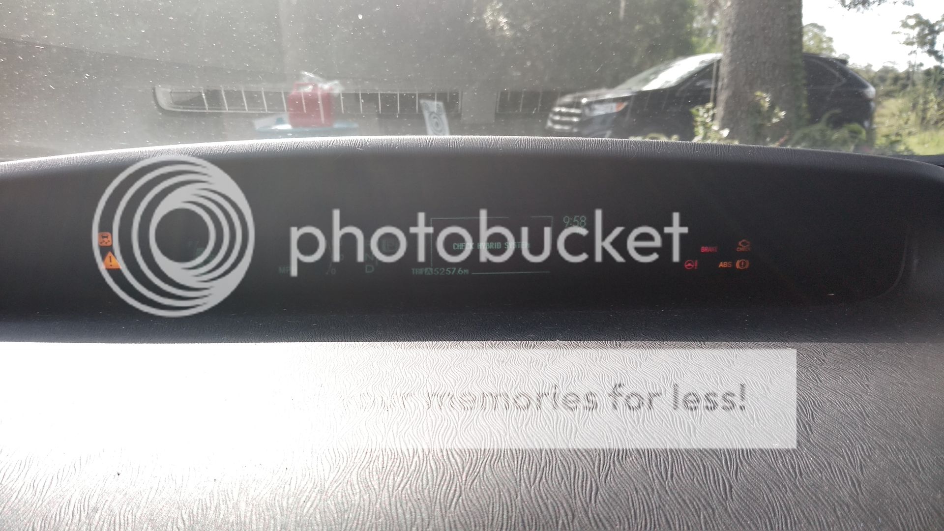

    So I think my HV battery may have just died on me a couple days ago. The car will not drive, dash lit up like a Christmas tree and Check Hybrid System message.
    The car is a 2011 with 134533 miles.
    I called the two nearest Toyota dealerships, St. Augustine/Jacksonville Florida area, and both want over $2500 just for the battery, not installed.
    Does anyone know of any good hybrid/Prius shops in my area or in Florida?

    The most important thing right now is to determine what your actual fault codes are to determine if it truly is a battery issue. If it is a HV battery problem, I may be able to help you out.

    test the 12v health
    check for movement in the inverter fluid reservoir.
    clean the hybrid battery cooling fan and intake grille
    have you had the recall done? this is not necessarily the battery

    @TMR-JWAP is really good. He knows the Prius well. And as he said, read the codes with a Prius-literate code reader to see if it really is the battery or something else in the hybrid system. As @bisco mentioned, there is Home - Tampa Hybrids Inc. over on my side of the state. He's terrific, but it's a bit of a drive.

    Unfortunately whatever the issue is with mine its making it to where it will not drive.
    So tomorrow its getting towed to the local Toyota dealer, Beaver Toyota in St. Augustine FL.

    i mean do you have any kind of scanner to get codes so you know more than just that dash is lit up ?
    That is about the right mileage for HV NiMh to start crapping out - yeah stay AWAY from the STEALERship , -- seriously, there's a reason they sit u down into a wifi area with free coffee , popcorn and home theatre ...
    there are some 'hybrid battery doctors' in tampa and sarasota , but BE CAREFUL and dont go the route i did with the 'fly by day' craigslist guy ...

    (and then he said he's moving and doesn't have time -- yeah bat check .. well voltmetter only tells you so much, you really need a load tester to determine 12v health - and its a SLA not a starter bat so is the load tester even going to give the kind of reading desired ( Amp Hours of drain, not Cold Cranking Amps of starting power)
    invertor fluid ez to check pump operating
    Cleaning the hybrid fan, requires the rear panel disassembly , prob. 1/2 hour min. and some (preferabbly) clutter and distraction free environment where parts and piece are going to get laid out ...
