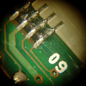

    I took out my MDF(photo1) and to replace its gonna cost me around $500 so I'm looking for something else to replace it even if it doesnt have all the funcions, I need backup camera, for sure and the socket has to be compatible to the wires (photo2), thanks in advance 20211016_133837.jpeg IMG-20211016-WA0004.jpeg

    Get a working replacement from a salvage yard. Make sure to get one with the exact same part number, which looks like -47220 (?) in your photo.

    Good question, and would be curious to know if it failed from a hairline crack at pin 60 (or nearby).
