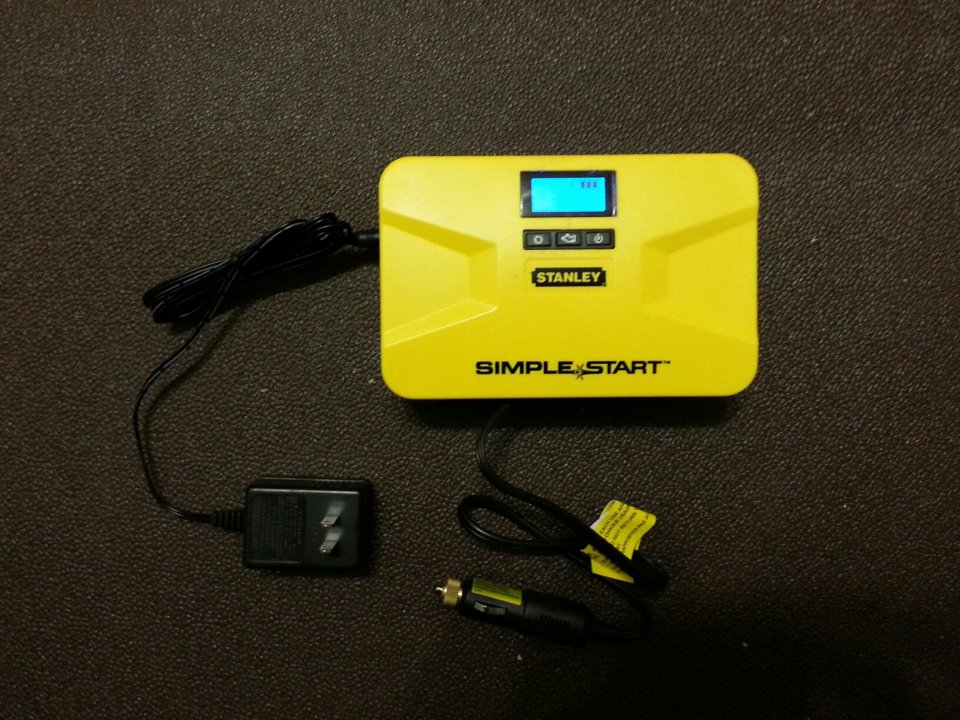

    There is a You-Tube video that appears to have a solution to this problem, which I don't consider to be an ideal one, albeit effective:
    I believe the auxiliary battery is already an AGM deep-cycle battery. There used to be a car battery with a small partition, which you could use to boost the dead part by turning a switch. Perhaps one of the business analysts at Toyota believed that this problem was a good way to drive customers to the dealers for service.
    This will solve it for now:
  16. jdk2
    jdk2 Active Member
    Mar 6, 2010
    751
    220
    Raleigh, NC
    2013 Prius Plug-in
    Uh, I don't think that will work. The cigar lighter isn't hot except when the ignition is on.
    A battery tender works though.
  17. GregP507
    GregP507 Senior Member
    Apr 5, 2014
    3,002
    481
    Good point. I may need to attach alligator clips, so I can boost at the fuse box.
    I use a battery tender on another vehicle to keep the battery up when it's parked for long periods. Not sure how it would help this problem.
