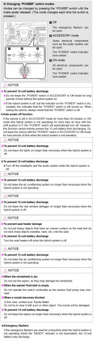

    From my post #66 in this thread
    "How inconvenience is it to press brake and power button to put vehicle is READY mode where the large traction battery gets connected to the vehicle power circuits and the ICE will run as needed?"
    So READY mode is the way to go if you are sitting and using anything electrical in the car.

    In Ready mode it turns on the climate controls, the dash lights, the running lights, and all manner of other power drains. I don't think it's unreasonable to try and avoid that by using ACC mode. Besides, if ACC mode is useless, why is it there?

    Why is it there? (Ignition On or ACC mode)
    For me it is there to use car electrics for less than 5 minutes. When I need to roll up a window that was left down for example.
    From design standpoint, I would guess that it is there to make the Prius more like a traditional car. I would also guess that for safety reasons the main attraction battery must be isolated when not in use, therefore not available to charge the 12 V or start the computer/car.

    A better question is: Why do people read things into statements that never were said ???
    No one ever said that ACC is useless.
    What we are trying to say is that it might not be APPROPRIATE, or the best choice, if you need to run any of the electrical accessories for a LONG period of time.

    FWIW I'd say the owners manual does a pretty good job of cautioning against using accessories for extended periods when not in ready mode.

    Sure you got a new 12 volt batterie free from the dealer, that's great. But you still will find out that continued use of the acc position for extended periods (deep discharging it) of time will trash that battery too.

    Toyota did listen to customers in the design of the ACC and IGN-ON modes. Compare the Gen III and PIP with the older generations. The Gen III/PIP in ACC have (I believe) just the radio/audio system on, with the display off completely. In previous generations, as complained about here and other places, some of the display came on wasting power.
