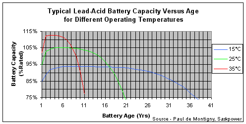

    An interesting article: "Battery life and death"
    That batteries have a finite life is due to occurrence of the unwanted chemical or physical changes to, or the loss of, the active materials of which they are made. Otherwise they would last indefinitely. These changes are usually irreversible and they affect the electrical performance of the cell. This page describes the factors influencing battery life.
    Battery life can usually only be extended by preventing or reducing the cause of the unwanted parasitic chemical effects which occur in the cells. Ways of improving battery life and hence reliability are also considered below.
    Calendar Life and Cycle Life
    Battery performance deteriorates over time whether the battery is used or not. This is known as "calendar fade". Performance allso deteriorates with usage and this is known as "cycle fade"
    Battery Calendar Life is the elapsed time before a battery becomes unusable whether it is in active use or inactive. There are two key factors influencing calendar life, namely temperature and time, and empirical evidence shows that these effects can be represented by two relatively simple mathematical dependencies. The Arrhenius Law (see below) describes how the speed of chemical reactions increases with temperature, in this case the rate that the slow deterioration of the active chemicals increases. Similarly the t1/2 (or √t ) relationship represents how the battery internal resistance increases with time t.
    Temperature effects
    Chemical reactions internal to the battery are driven either by voltage or temperature. The hotter the battery, the faster chemical reactions will occur. High temperatures can thus provide increased performance, but at the same time the rate of the unwanted chemical reactions will increase resulting in a corresponding loss of battery life. The shelf life and charge retention depend on the self discharge rate and self discharge is the result of an unwanted chemical reaction in the cell. Similarly adverse chemical reactions such as passivation of the electrodes, corrosion and gassing are common causes of reduced cycle life. Temperature therefore affects both the shelf life and the cycle life as well as charge retention since they are all due to chemical reactions. Even batteries which are specifically designed around high temperature chemical reactions, (such as Zebra batteries) are not immune to heat induced failures which are the result of parasitic reactions within the cells.
    The Arrhenius equation defines the relationship between temperature and the rate at which a chemical action proceeds. It shows that the rate increases exponentially as temperature rises. As a rule of thumb, for every 10 °C increase in temperature the reaction rate doubles. Thus, an hour at 35 °C is equivalent in battery life to two hours at 25 °C. Heat is the enemy of the battery and as Arrhenius shows, even small increases in temperature will have a major influence on battery performance affecting both the desired and undesired chemical reactions.
    The graph below shows how the life of high capacity tubular Ironclad Lead Acid batteries used in standby applications over may years varies with the operating temperature. Note that running at 35 °C, the batteries will deliver more than their rated capacity but their life is relatively short, whereas an extended life is possible if the batteries are maintained at 15 °C.
    Battery Life and How To Improve It
