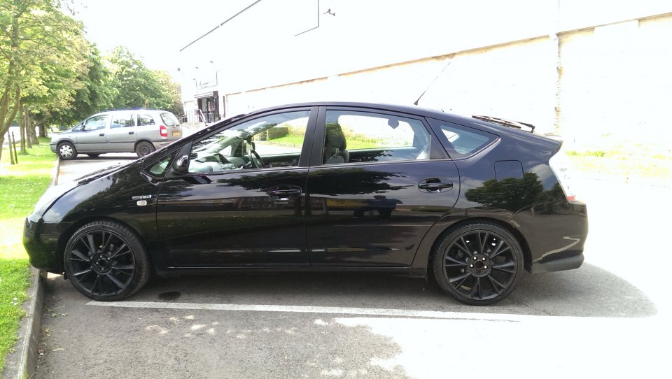

  18. keleee
    keleee New Member
    May 10, 2014
    Bath, Somerset
    hello
    I found wheels, now need to get lowering springs :)
    Kevin_Denver and Justdidit like this.
  19. Daves09prius
    Daves09prius Active Member
    Nov 20, 2010
    680
    161
    Gettysburg, PA
    Those rims and tires look nice! can you tell us more about them, where did you order them from?
  20. Justdidit
    Justdidit LVNPZEV
    Jun 12, 2012
    1,880
    711
    75
    Carrollton, Texas
    Four Touring
    Looks good. Tell us a little more about them.
    and YES, drop that thing!
