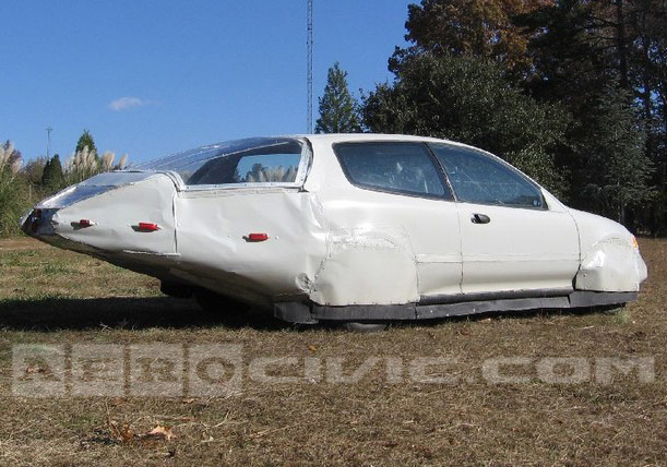

    I've been thinking of adding an inflatable tip at the back of an RV, like the 'tip' of a droplet of water. In the Netherlands that could even cover the bicycles on the back.
    Something like this but inflatable (preferably even inflated by driving speed):
    I sold my RV some years back, so not that much chance of testing myself...
