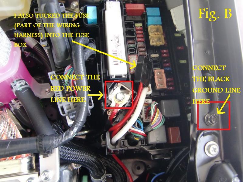

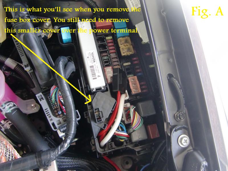

    Ok, almost done with my project. Headlights painted and Retrofits in place. Where did you hook the 12v for the relay harness?
  6. mrstop
    mrstop PWR Mode
    Jun 22, 2012
    742
    329
    109
    Cincinnati, OH
    Hook the 12V into the fuse box. There's a squarish cover on the bottom left of the fuse box as you're facing it. Here's a pic from Nola-Prius' post:

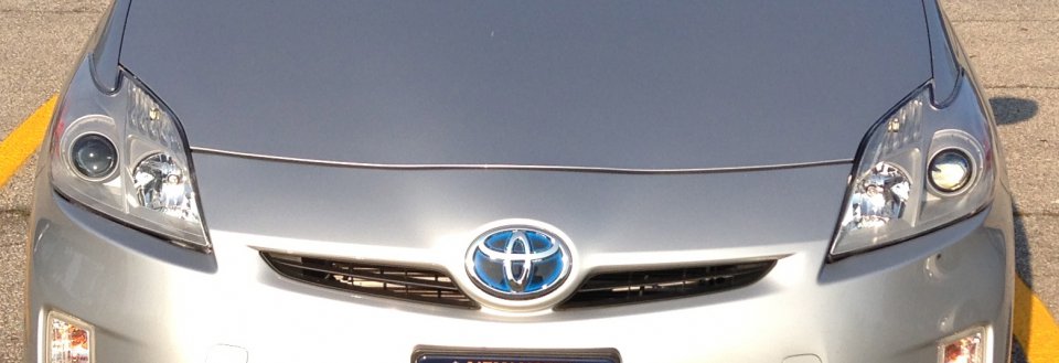

    so, inspired by this that this project started for me
    I ended with this
    but not without its snags.

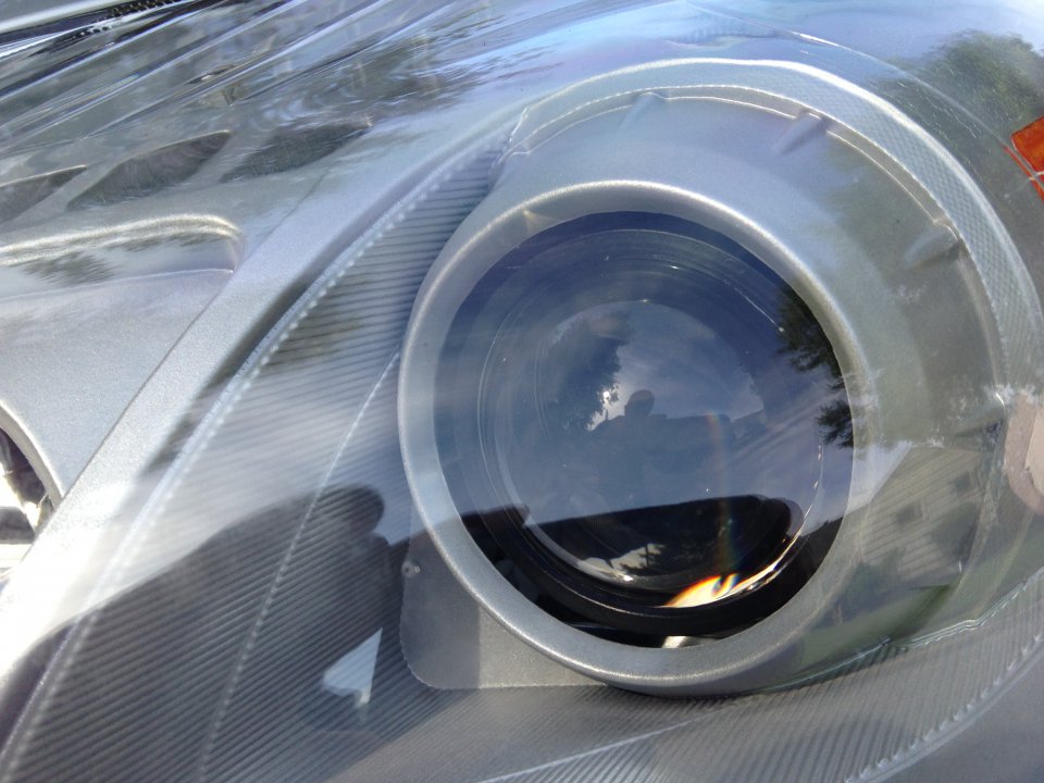

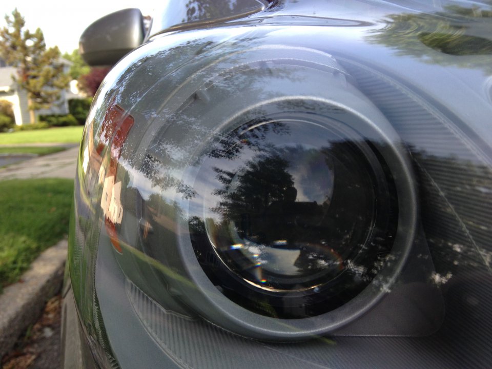

    When putting back together again, between being this the first time I ever tackle a project like this, rushing, and so on, the projectors did not seem aligned with the shroud. I feel that when the glue cooled and everything back in place, well I did not see that the projector got snagged a bit with the shroud. Hopefully, the next pics will show that a bit. Hard to tell with reflections.
    Left headlight --> leaning towards outside and down
    Rightside --> snagged on top.
    IMG_1810.JPG So, patiently today, opened it up, made sure lights were aligned and put back together. When doing so, I made sure that the shroud was not touching the projector at any given point of the process of closing.
    Now, both side look almost perfect.
    No dishing the paint skills as that was a first too. Maybe one day, I will open again, sand off not so good parts and paint over.
    Enjoy!
    How about now I go quads? Use the highbeam for another pair, paint and presto. Bet this would make my prius unique ;)
    Dylan Doxey and mrstop like this.

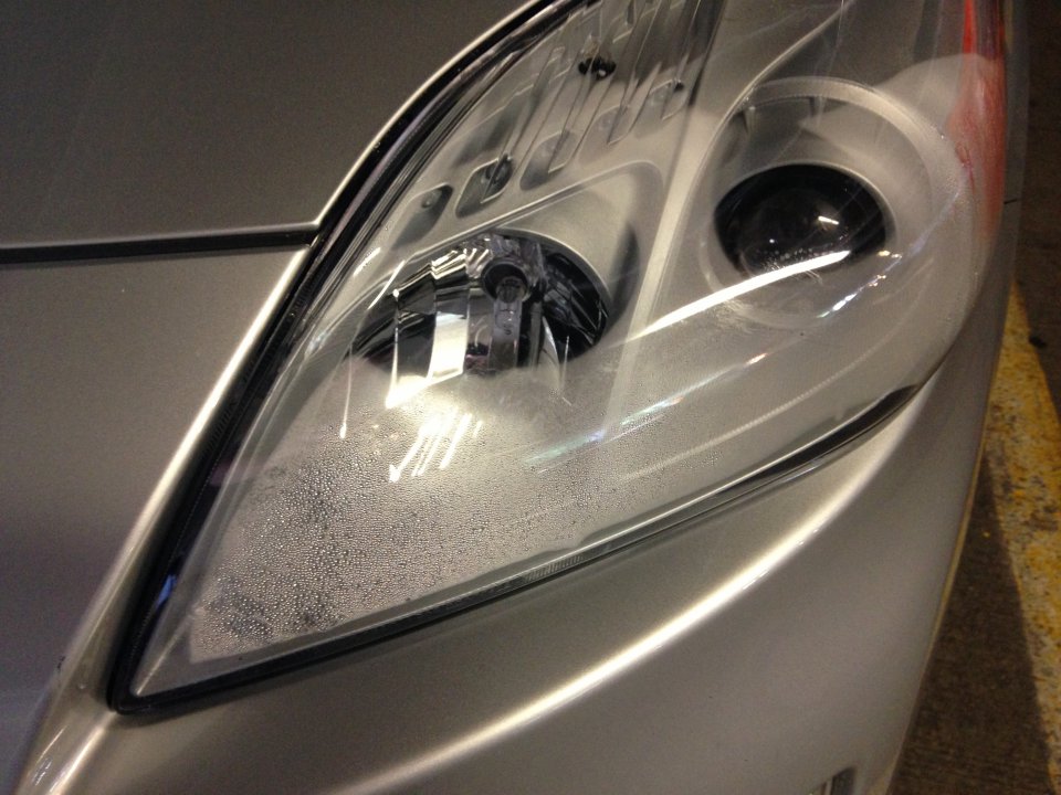

    Looks good but I hope u baked just the shroud at low temp to fully cure the paint. If u didn't, u should.
  16. swaggingprius
    swaggingprius Member
    Nov 7, 2011
    88
    29
    21
    East Coast
    Oh, shoot! I guess I did something wrong :cry:. I only see it on this headlight.

    Bad seal, water got into the housing and now you have condensation.

    I did not exactly baked it in the oven. I left them in my attic for about three days before installing. I am pretty sure they got baked enough.
    I bought the black guppy stuff from Retrofit Source. Baked headlights, opened, added the stuff, and baked again. So far it seems to have worked :))))
