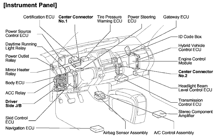

    It should be right there (behind the MFD) :
    Why do you need to replace the ECU?

    Where exactly it is? I really couldn't find a tmps receiver. It's unclear on the picture,

    What part are you looking for? The TPMS ecu mounts in the dashboard in front of the MFD.
    The TPMS receiver mounts in the right side of the cargo area, "behind" the little triangle window, underneath the upper plastic interior trim? Screenshot_20220821-153830.jpeg Screenshot_20220821-153906.jpeg

    As mr_guy_mann pointed out, the OP asked about a TPMS "module". If the OP meant the TPMS ECU, that's in the dash as shown; if the OP meant the TPMS receiver, that's back in the hatch area.
    The photo in the original post is of a TPMS receiver, so, that would go back by the hatch.
