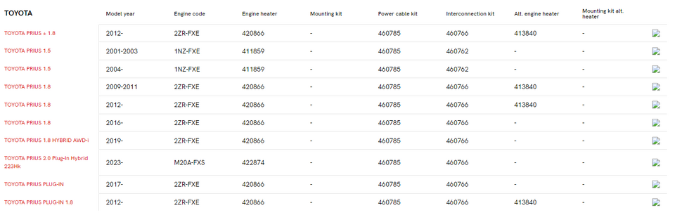

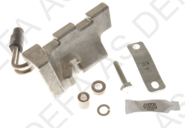

    I've got a DEFA 300W oil pan heater - they're the leading brand around here, but it's not clear to me how readily available they are in North America.
    Oh, and it's 230V - forgot the voltage thing. Hmm. Maybe not the best suggestion for you, but info might be useful to someone.
    https://www.defa.com/electrical-preheating/engine-heaters/
    And I've just noticed that they only list the plug-in G5, which makes sense as that's the only version in Europe. But should be compatible with the non-plug-in. Same part fits various UX, C-HR and Corolla and RAV4 with the same engine.

    Bolts on. Not invasive. Nice.

    This is very interesting.....wonder if a version of this was available for the US market.
