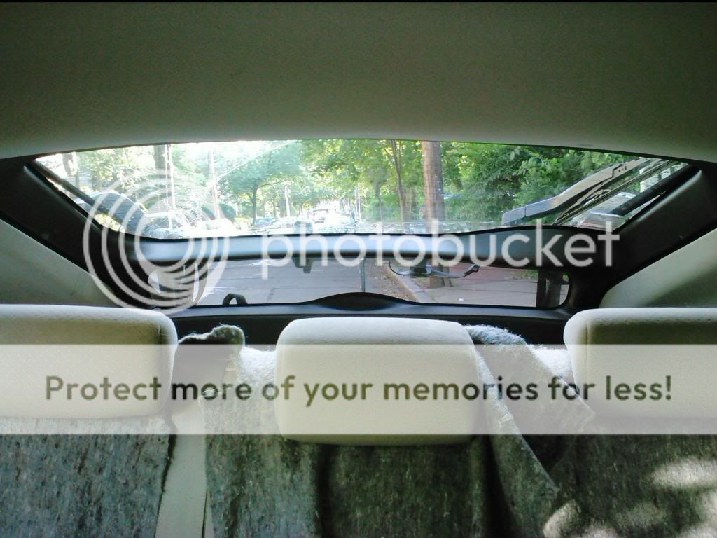

    I used a 22" front wiper - works great! ( - It will actually accommodate up to a 24"). Had to modify it a little to fit: wiper arm is 12.5 mm wide with a 6.5 mm diameter groove to accept the wiper pin. On the "universal" wiper I bought, removed the plastic insert. The metal frame holding the pin was <12.5 mm (note that not all front wipers are the same width) and the wiper's pin was <<6.5 mm diameter. So I pried the wiper's frame apart to either side of the pin until it was just wide enough to fit the wiper arm. Here is a photo from the inside; will try to post close-up later
