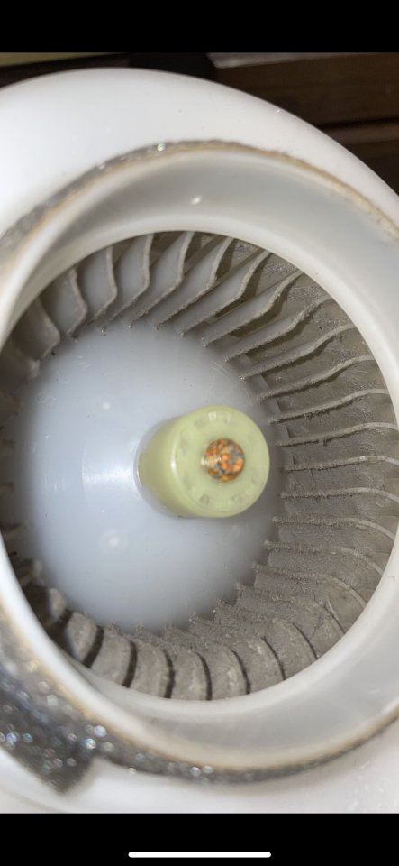

    Check out how dirty my cooling fan was after 78k miles! The filter might be nice in my case

    The filter at the inlet will have limited efficacy. I put something similar (window screen material) behind the inlet grill on our 2010, but (like the Toyota filter) it's just a coarse screen. It'll catch a bit but it's not going to make a big difference. It's sorta canary-in-the-coal-mine, ie: if the screen at the inlet is looking dust, the fan and ductwork leading to it likely is getting dust too.
    Anyways, I would look on this coarse-grid inlet screen as "solution" for fan dusting up. It could actually be risky, if it was extremely effective, might reduce air flow too much.
