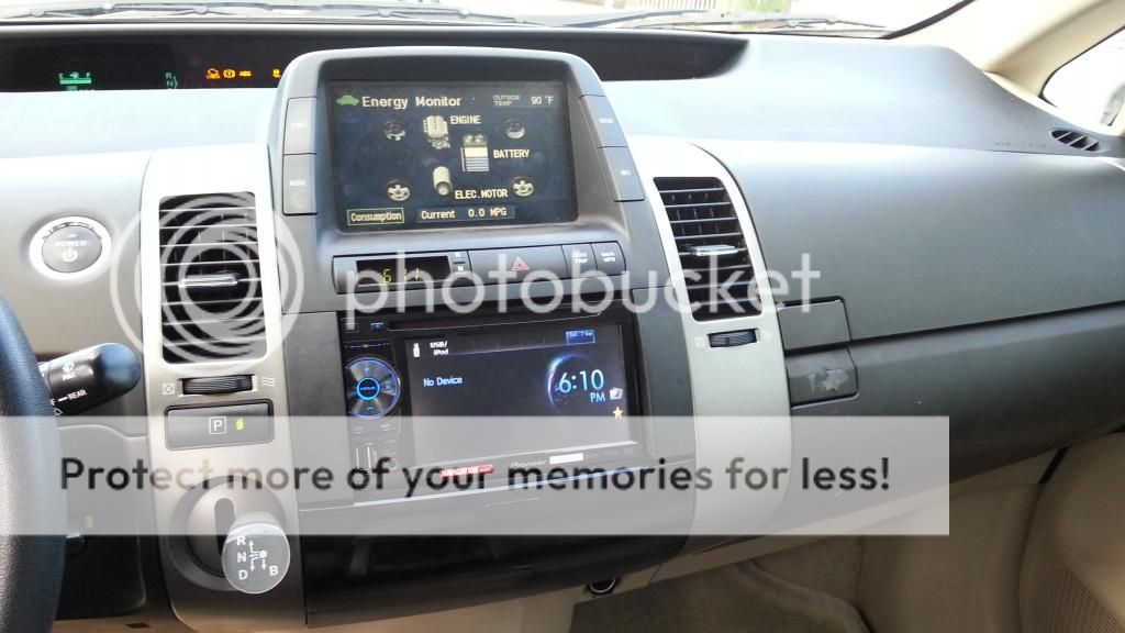

    I like the touchscreen, mainly because it makes it easy to navigate the files of my flash drive and change settings. Its a solid entry level unit if you don't need bluetooth, HD radio, or navigation. The AVH-X1500 is the newer version, and its even cheaper than what I paid for mine a year ago.
    The harness I got for the Prius side of my install had a wire labelled "dimmer". I hooked it up to the dimmer wire for the radio and it works great. Hopefully the JBL harness has one, too.

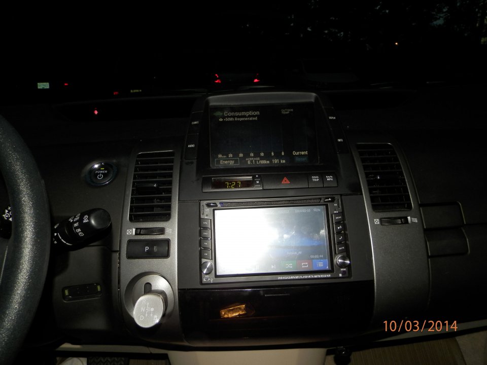

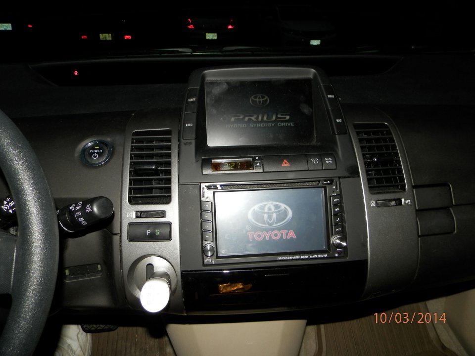

    This is mine
