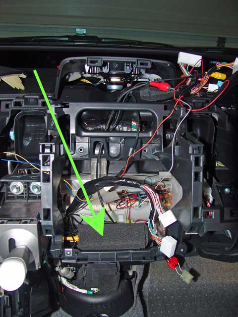

    Well I got the first part of the installation done. I now have a working anytime rear camera! :D
    Tomorrow I get to install the front camera! :D

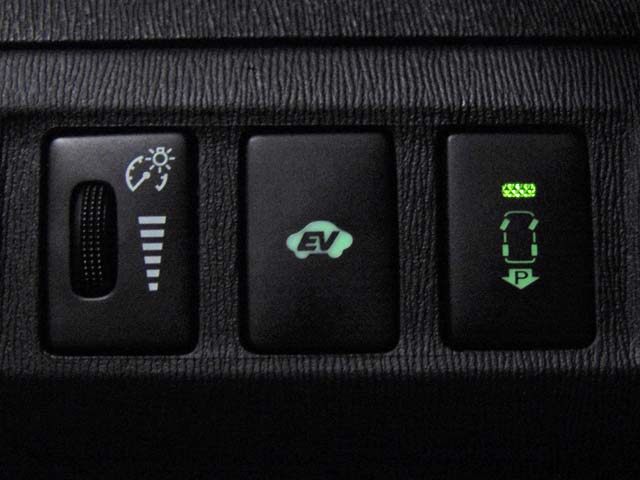

    So far the switch works great just like it should. It switched from the front to the rear then off. It also powers the indicator LED on the IPA switch and sends 12v to the front camera when activated.
    More pictures and maybe a video tomorrow. :D

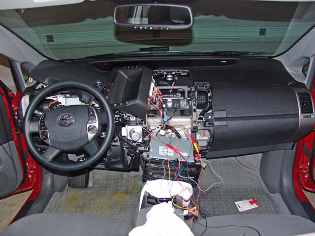

    Some disassembly required. :eek:
    Close up of my mess.
    Here is where I put my switcher box. It fits perfect right behind the radio. B) I put some foam tape around it to keep it snug and quiet.

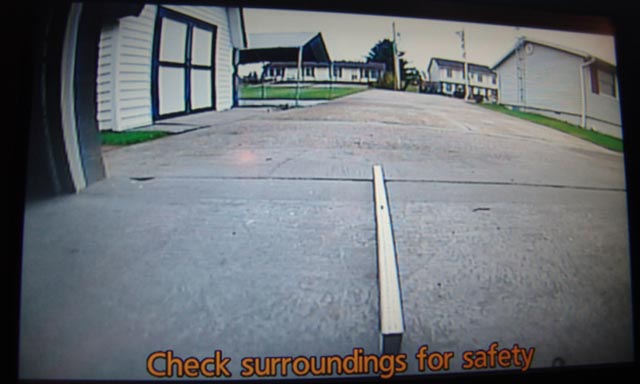

    It was dark so I did not get any good screen pics but you can see the road pretty good if you turn the fog lights on. Hay I guess the fog lights are not that worthless after all. :)

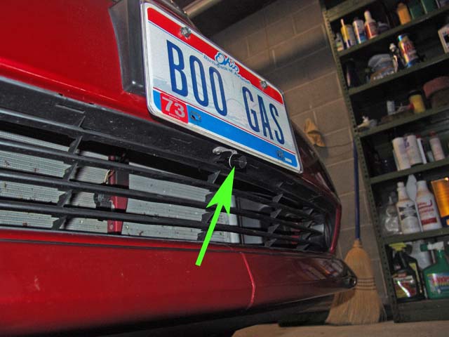

    Here is where my camera is.

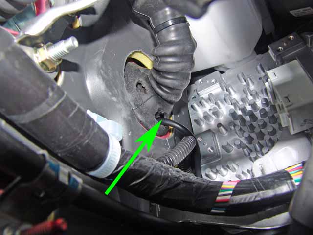

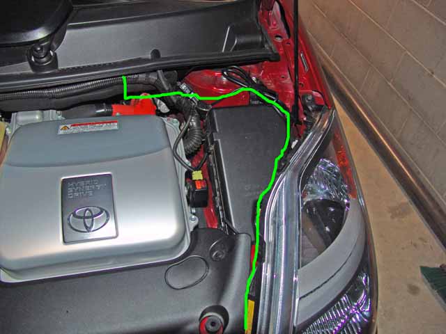

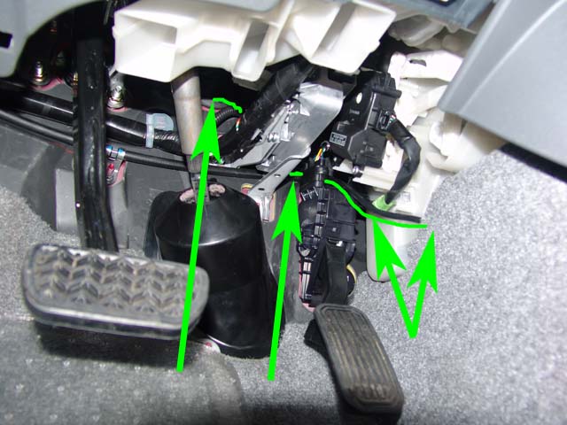

    I did punch through the rubber boot in the firewall to run the wire through. The wires I ran along the wall of the driver side of the engine compartment. The wires in the inside I was able to hide in the center area below the radio behind the plastic thing.
    I'm a little worried about rocks but after having my car for 11 months now I dont really see any major dings around that area from rocks. If the camera gets busted I guess I will have to buy a new one.

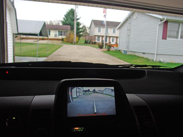

    Here is what the camera can see.
    Here is a close up of what it can see.
    Here is the IPA button illuminated and the indicator LED lit.

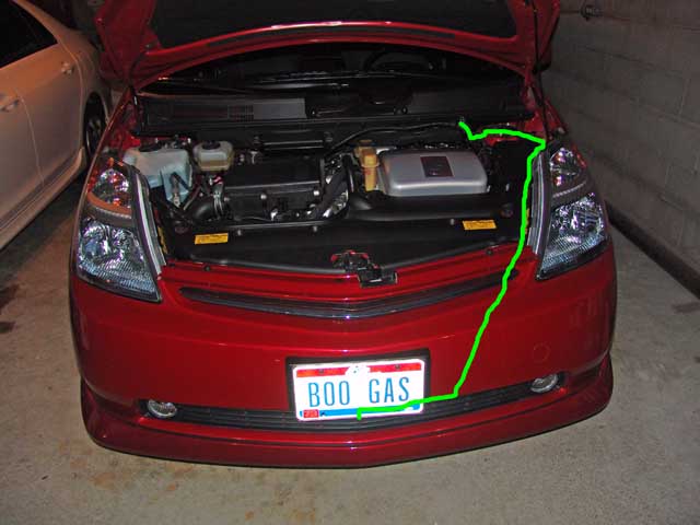

    Here are some wire routing pics. Hope this helps.
    The bright green line is how I routed the wire.
    Close up of the driver side engine area where the wire is routed. There is a split right on top of the fuse box so if I need to take the bumper off I can dissconnect it. I had a few feet left over so I bundeled it up and use a wire zip strap to hold it above the fuse box.
    Here is where I got through the firewall. My first attempt failed and I had to try another location. For some reason I could not see my coat hanger on the other side so I decided to try a different location and got through.
    I routed the wire down behind a metal box and then in between the accelerator box and what ever that was above it. That hole was just big enough for the connectors to go through. I then routed it behind the carpet and up through the back of the center area below the radio.
