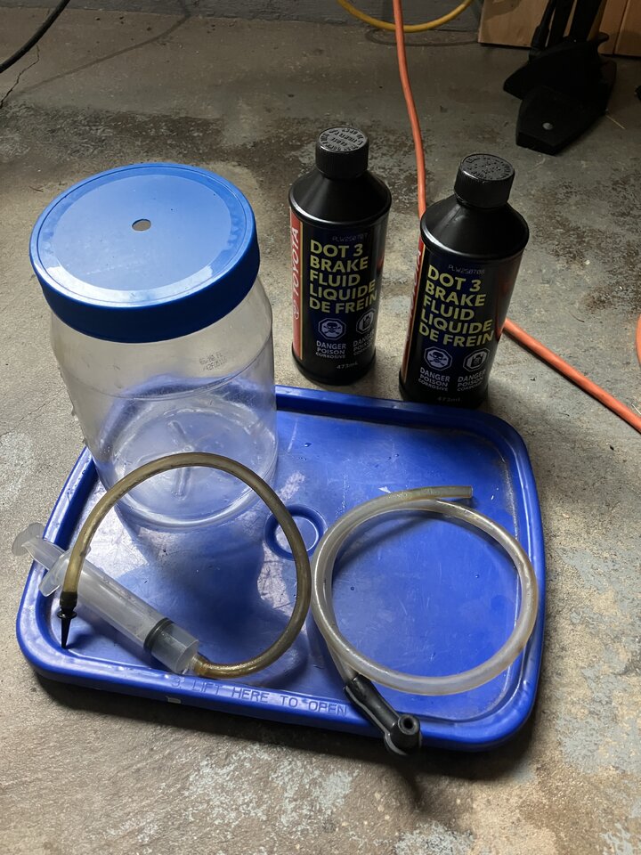

    Do you have pictures of these rudimentary tools? I just finished the transmission fluid replacement and have some vinyl tubing left over.
    I’m assuming my car never had any brake fluid changed and I’m at 111k miles. DIY’ing a vacuum bleeder with recycling bin scraps is my idea of a good time.

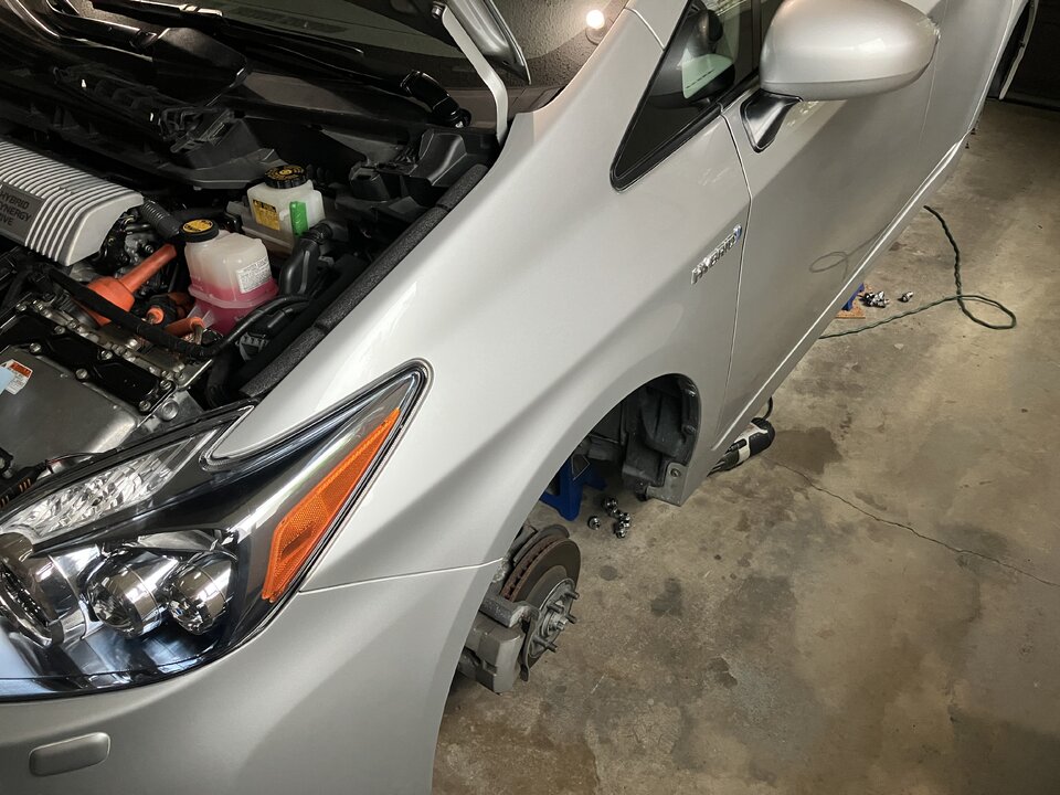

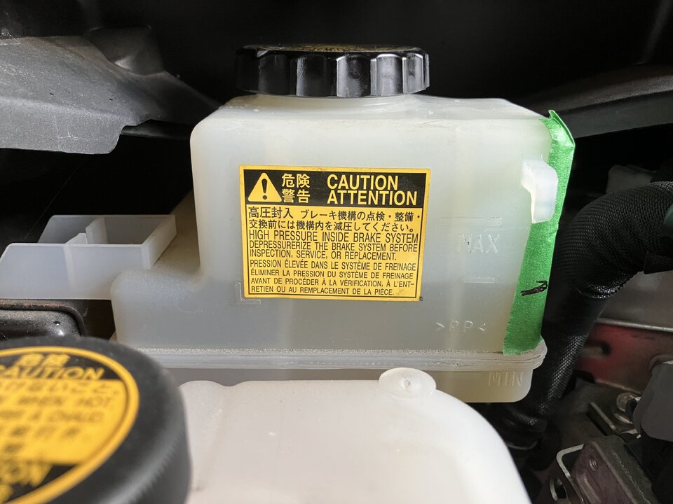

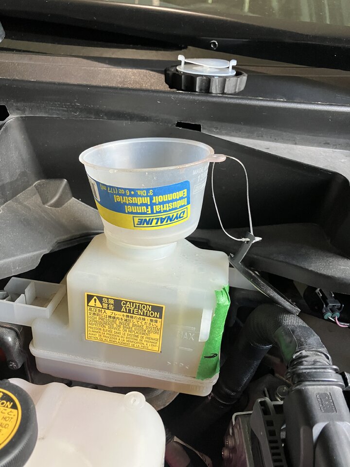

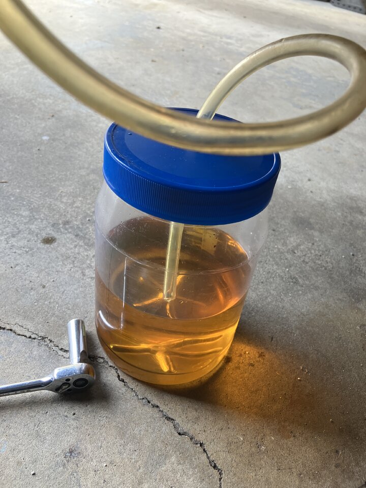

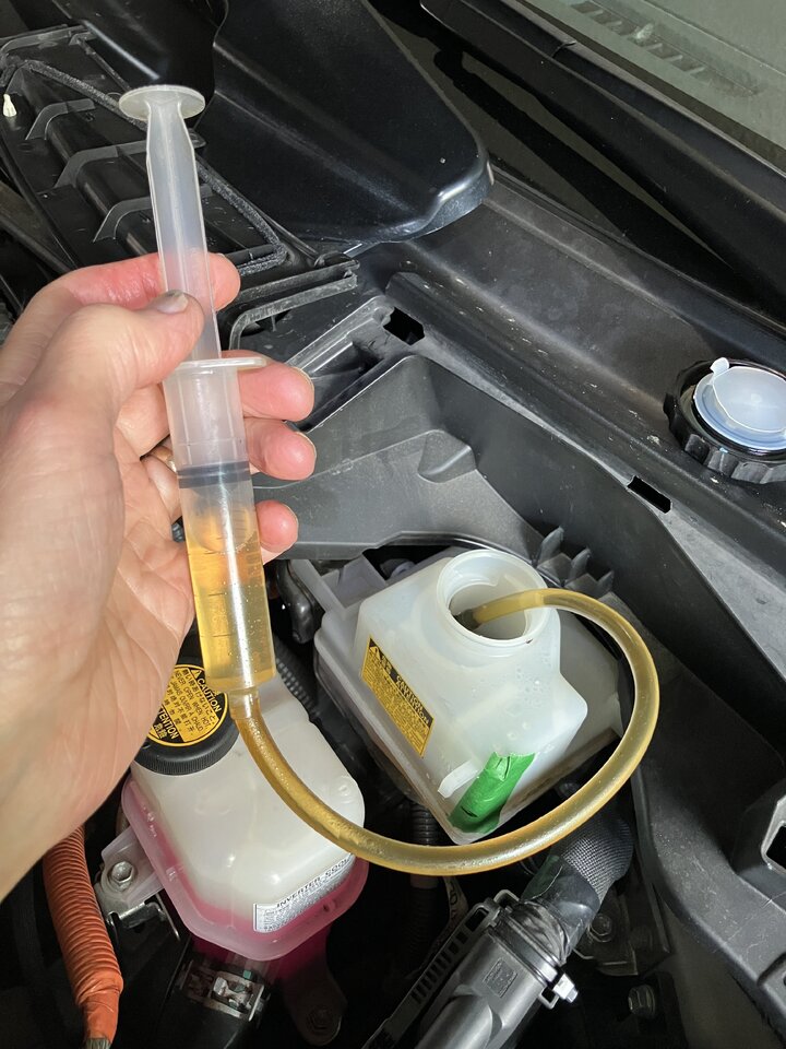

    Recently started thinking it must be getting close to 3 years on the brake fluid (Toyota Canada is 3 years or 48k kms (~30k miles), checked my log: ah whoops, coming up on six years.
    I’d purchased a couple of pints of Toyota DOT3 a week or two back, got into it yesterday, with the car up on jackstands for snow tire swap.
    my wife helped, pushing brake pedal, good to have all windows rolled down.
    There’s a link in my signature, more info on brake fluid change, earlier in this thread. (On a phone turn it landscape to see signatures).
    my illustrious kit:
    Invalid mode:
    various:

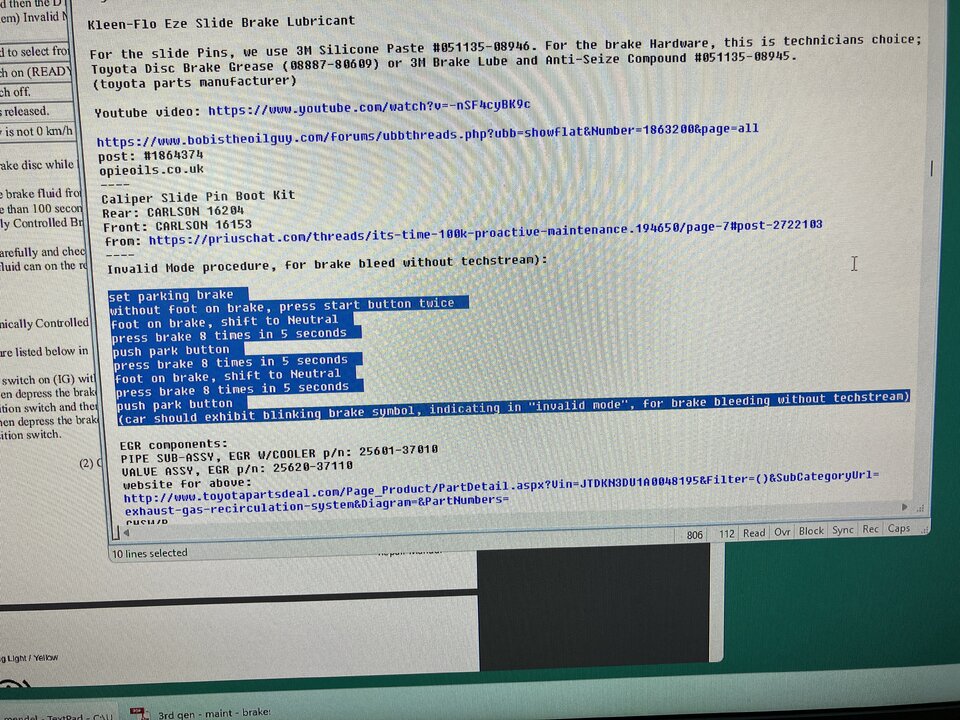

    @NutzAboutBolts video might clarify. I followed the order per repair manual (front/right first, then go around counterclockwise), but other'n that:
    ^To keep ahead of Chap, it should be called "replacement", not "flush".
    The "old school method", for brake fluid replacement, from the gen 3 repair manual, is attached.
    A couple of gotchas with :invalid mode":
    1. parking brake must be set
    2. to shift to Neutral you need to depress brake pedal
    #49 Mendel Leisk, Oct 10, 2025
    VelvetFoot likes this.
