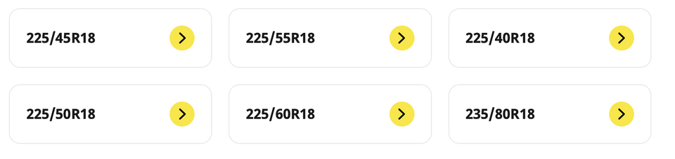

    Hello, just not clarify
    Are you stating that you are using Michelin 225/18 A/S4 tires will fit on a 2025 Prius OEM rims that came with 19" tires ?
    Also I am a bit confused as there are multiple "225/18" tires listed on the Michelin site.
    What actual width 225/ ??? R18 Michelin tire are you using on the OEM rims ? Screenshot 2025-07-01 at 7.21.33 AM.png

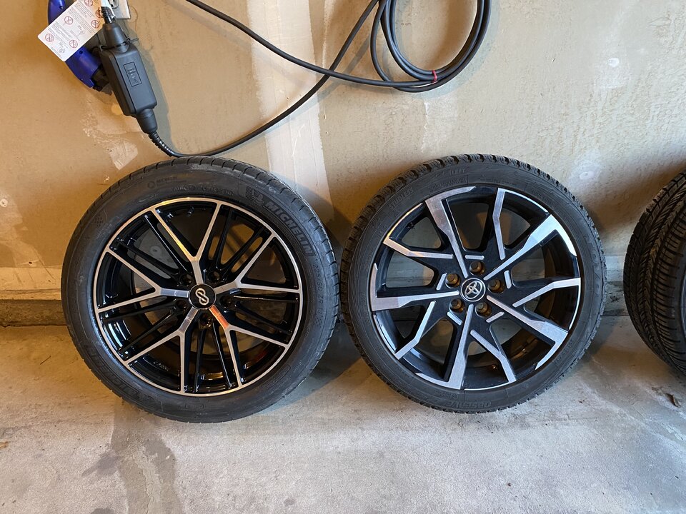

  13. thetoys
    thetoys Member
    Jun 11, 2023
    Toronto, ON
    2024 Prius Prime
    XSE Premium
    225/50 R18
    GcinFl likes this.
