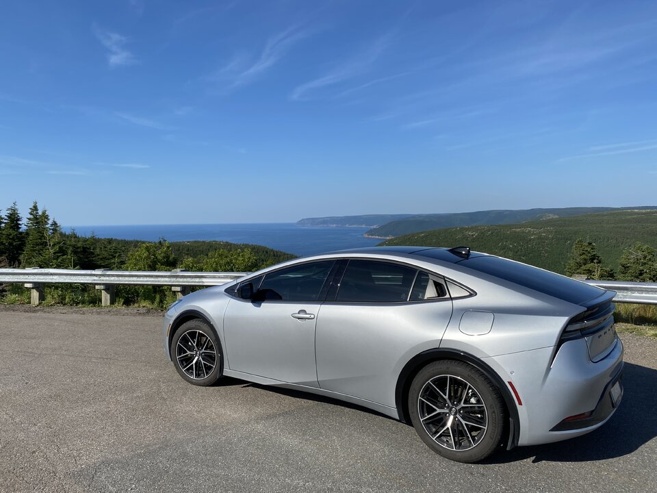

    IMG_2967.jpeg Glad that I put 225/50 R18 Zrated tires on the Prius. Cabot Trail is Awesome. Would recommend to anyone. Road has a lot of high speed corners in quick succession and elevation changes for hours on end. In Sport Mode the Prius got at least 10 to 15 miles of added EV range just from just regenerative braking while my daughter was driving in the last leg of the trail. Speed limit is 80 KPH (50MPH). Doubt that OEM 195/50 R19 would of handled the trail as well.
