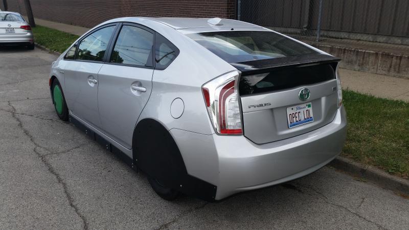

    Get the best rated LRR tires and crank up the pressures to uncomfortable levels and start making aero-mods: taping off front end gaps, plexiglass covers over grill openings, solid wheel covers, fender skirts, remove mirrors, lower car, lengthen front skirt, etc.
    Or just slow down.

    Lower grill block.
    Never 100% block if engine load is high such as uphills and or blasting AC. Can be easily remove and reinsert as needed.

    This^^^
    Start reading here and then buy this book. You'll end up with something that looks like this:
