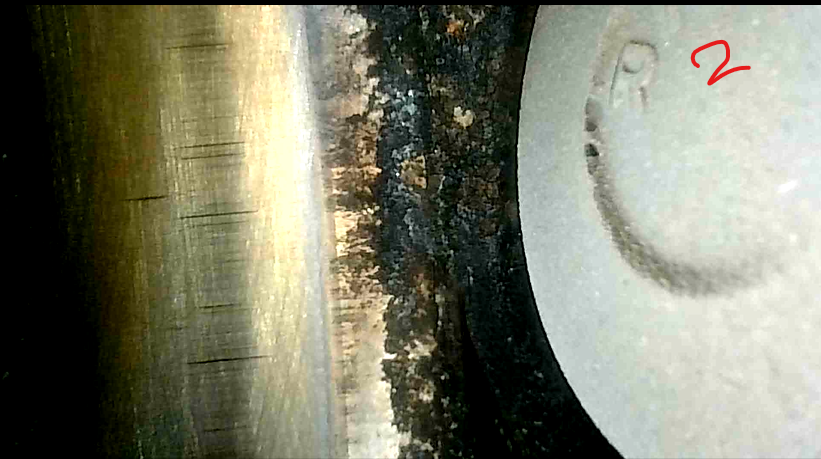

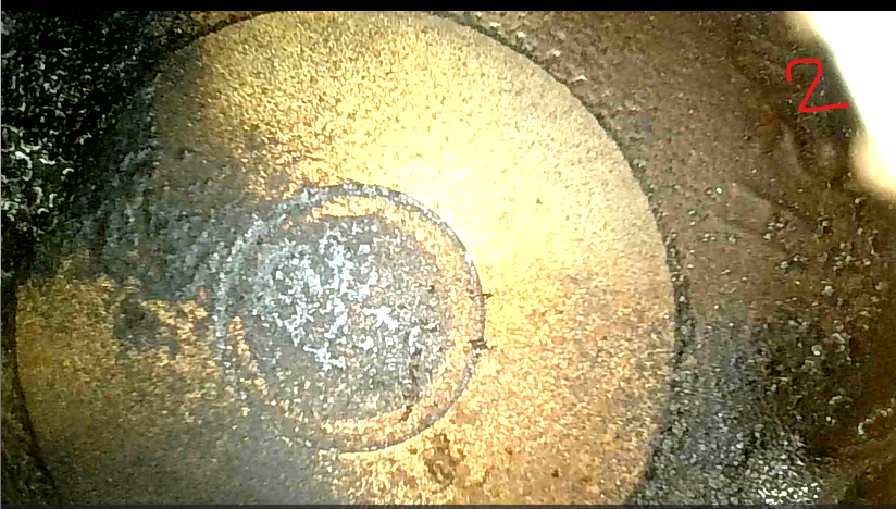

    I scanned for codes and it reported misfires in cylinders 3 and 4. Per the Car Care Nut's video on diagnosing head gasket issues, I decided to take a look with a borescope. I took everything apart, and in the process the boot for ignition coil 4 ripped due to being super stuck.
    Here is what I found in the cylinders:
    cylinder 2 - side.png (are these scratches on the side concerning?)

    The facts that the pistons look reasonably uniform, and that you're not losing coolant are both encouraging signs. Even when the head gasket is ok, they do occasionally rattle alamingly on cold starts following very short trips, allegedly due to condensed water in the intake. Misfiring for any reason causes the scary noise.
    Mine has done the rattly start-up thing occasionally in the11+ years I've had it, but never in the past couple of years (unless we count a milder version in the first ~1 second). I don't know why not.
