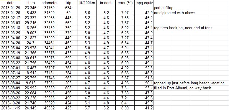

  15. Mendel Leisk
    59,916
    41,173
    Our stock tire is Michelin Pilot 215/45R17, and every winter I swap over to Michelin X-Ice2 195/65R15. The following's my calc's for 2013. Note, the comments as to when I switched from the Pilots to the X-Ice. The last tank, mostly on X-Ice is maybe a bit of anomaly (I hope), there was a lot of short trips, basically very low miles, about a month fill-up to fill-up. I guess what I'm saying, switching to 15" might help, but it's not night-and-day, and it's quite an expense. And come trade in time, having a V with 15" rims will likely depress interest...

  17. Mendel Leisk
    59,916
    41,173
    Well, they are snows. Seems to end up neck-and-neck with the 17's. The 17s are better for RR, but wider.
    And then they're slightly smaller OD, to confuse things further, LOL: the car think's it's gone further with the smaller OD 17's.
