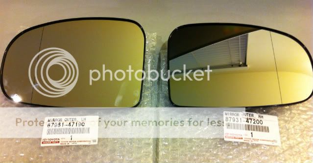

    Hey All,
    I just installed the EURO spec aspherical heated mirrors in both sides of the car. And it's nice to finally have a much wider view, I feel for safety it's just better to overlap turning my head and double checking, which I do a double take naturally on my motorcycle here in Los Angeles where people drive pretty aggressive.
    Here is a picture along with the appropriate part numbers. Even though these were about $250 shipped from England for the pair, it's cheaper than $700/pair for my 09 M3 Sedan (now that is highway robbery).
    Just wanted to give those who are in the US the information that you can get aspherical for both sides and they fit perfectly!
    Enjoy!

    Are the euro spec mirrors only convex on the outer third of the mirror? I see a line/split.

    Yep, I believe so.

    Wow, I could never go back to flat mirrors. Thankfully we follow the European rulings on mirror design.
    Btw, they are convex the whole way through but the line delineates between the 2 varying levels of convex angles and it's heated here too. Whilst it doesn't snow here, the mirrors invariably fog up often when going into a tunnel on a rainy day.

    So are the glass in these goldish/bronze look or is that the lighting in the room reflecting in the glass? What are so different about these than what comes in the 2012 Prius model 5?

    well.. I like digging up old threads. yes the mirror has a slight gold tint. I just ordered same models well only 1 is a Toyota the other is ALKAR 6471954 driver side. only the alkar came in so far but it's insane how wide a view it is. I moved it the far left to eliminate the side of the vehicle from the frame. But you can't do it! it's that wide of a view.
