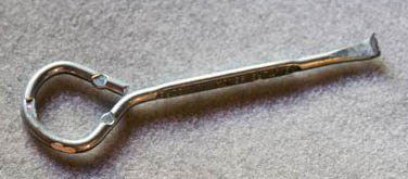

    For the 10 mm (socket size) bolts, I'm sure there is a torque value, but I would not get excited about it. Just reinstall them with a firm twist.
    For the fasteners, there's about 14 I think. I take the thing off with every oil change, and a couple of transaxle fluid changes so far. It takes under 10 minutes, both ways. There are a couple fasteners, in the vicinity of the "maintenance flap" that are grey coloured and definitely different in size from the rest. And within the rest there might be some subtle difference (length?) but I've given up on trying to keep them organized. With the two grey, larger ones, put a bit of white-out on the caps and the adjacent shield, as a reminder.
    As far as taking out the fasteners, a narrow flat blade screw driver, and more effective, a paint can opener, are helpful for getting them out. And before reinstalling them, wash them with soapy water, to float the grit/grime out of them. It helps to keep them from seizing.
    Here's a visual aid for the paint can fastener. Very hand for levering up the center cap:
