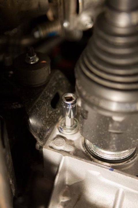

    The fill plug was a PITA to access and break loose due to the close proximity to the drive shaft and CV boot on the passenger side, and a lower crossmember. I had to keep turning the hex socket every which way to get a small angle of advantage with the breaker bar. There is no way that fill and drain bolt was torqued to the factory recommended torque of 29 lb-ft. :rolleyes: When I torqued the drain and fill bolts to the specified 29 lb-ft of torque, it sure didn't seem like it was tight enough, so I abandoned the torque wrench and just used some muscle to get 'em tighter. I didn't want any of that thin WS oil getting past the washers and bolts. :)

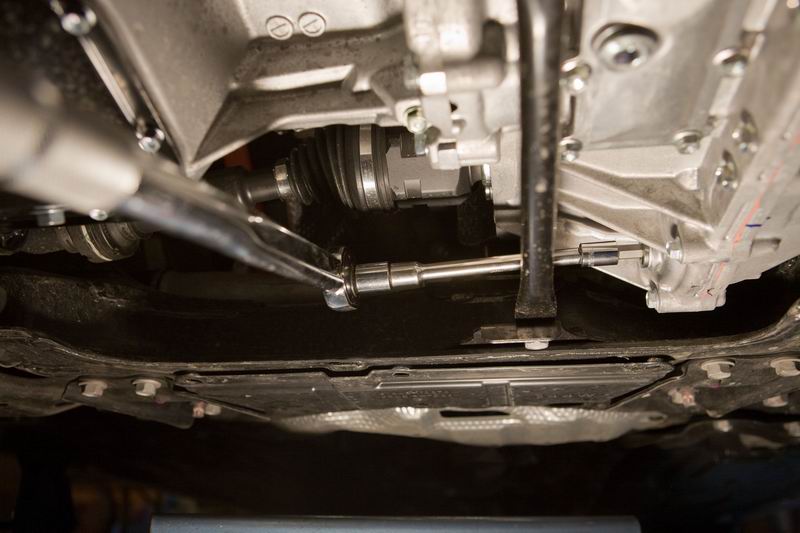

    I used an 18" extension on the allen socket and was able to do all the cranking out in the open away from the CV boot. And I did it all through the oil change door.

    ^ Yup, extension bars make it a lot easier.

    ^^ Wonderful photos
    By the way, the first time I replaced the ATF in our (v)agon most of my time was spent removing and reinstalling the air covers. I was more than a bit annoyed when I realized it was not necessary. I should have had more faith in Toyota.
  6. Mendel Leisk
    61,535
    42,347
    Did the drain mostly miss? I was nervous the stream would hit some plastic and then go everwhere, lol.
