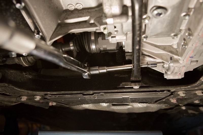

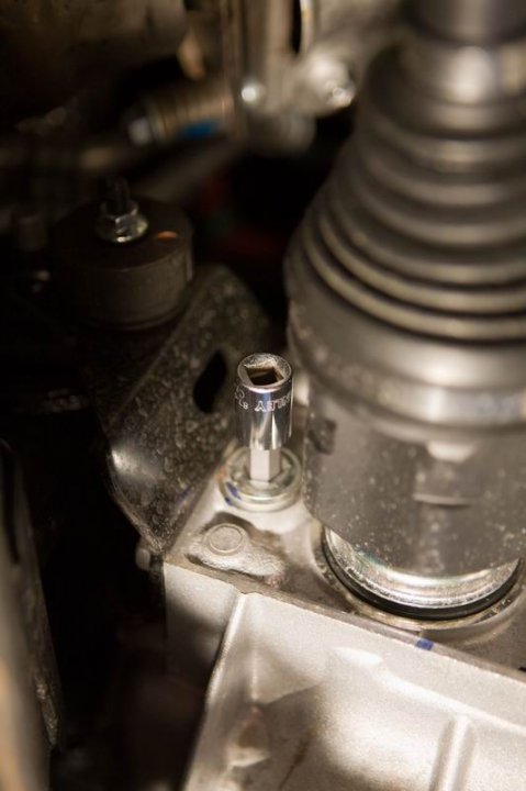

    The problem I see here is that you need a stubby hex and not the long hex that you have to fit your breaker bar without the extension. I used the stubby hex and it works fine.

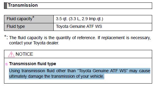

    I'm surprised (or maybe not) that people can read this in the Owner's Manual:
    And then the next question out of their mouths is: what alternatives can I use?
