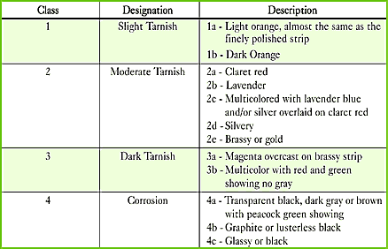

    Some lubes show this spec, some don't. But here's the test for that 1A or 1B number you see on some spec sheets.
    Some tech-nerd specs!
    Copper Strip Corrosion Test ASTM D130
    The Copper Strip Corrosion Test ASTM D130 is used to evaluate the corrosive tendencies of oils to copper containing materials.
    Table 1. Copper Strip Rating System ASTM D130
    In this test, special three-inch copper strips are cleaned, polished and immersed into a test tube containing the oil being evaluated. The test tube is held in a water bath for three hours at 212ºF (100ºC). At the end of the exposure period, the strip is removed and cleaned. The strips are compared to a specially prepared set of standardized reference strips and rated against these standards on a scale of Class 1 (slight tarnish) to Class 4 (heavy tarnish).
    An industrial gear lubricant that exhibits a 1b classification in this test is considered to exhibit good resistance corrosion to yellow metals.
