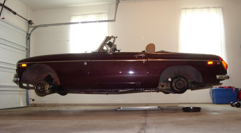

  1. xs650
    xs650 Senior Member
    Jul 2, 2010
    4,539
    1,436
    Northern California
    What happens if something breaks your concentration while you are doing that Jedi mind trick:D Squash you like a bug it will.

  2. KK6PD
    KK6PD _ . _ . / _ _ . _
    Mar 24, 2008
    4,003
    946
    118
    Los Angeles Foothills
    You know, if Skywalker sees you have repainted his speeder to purple, he's gonna be pissed!
