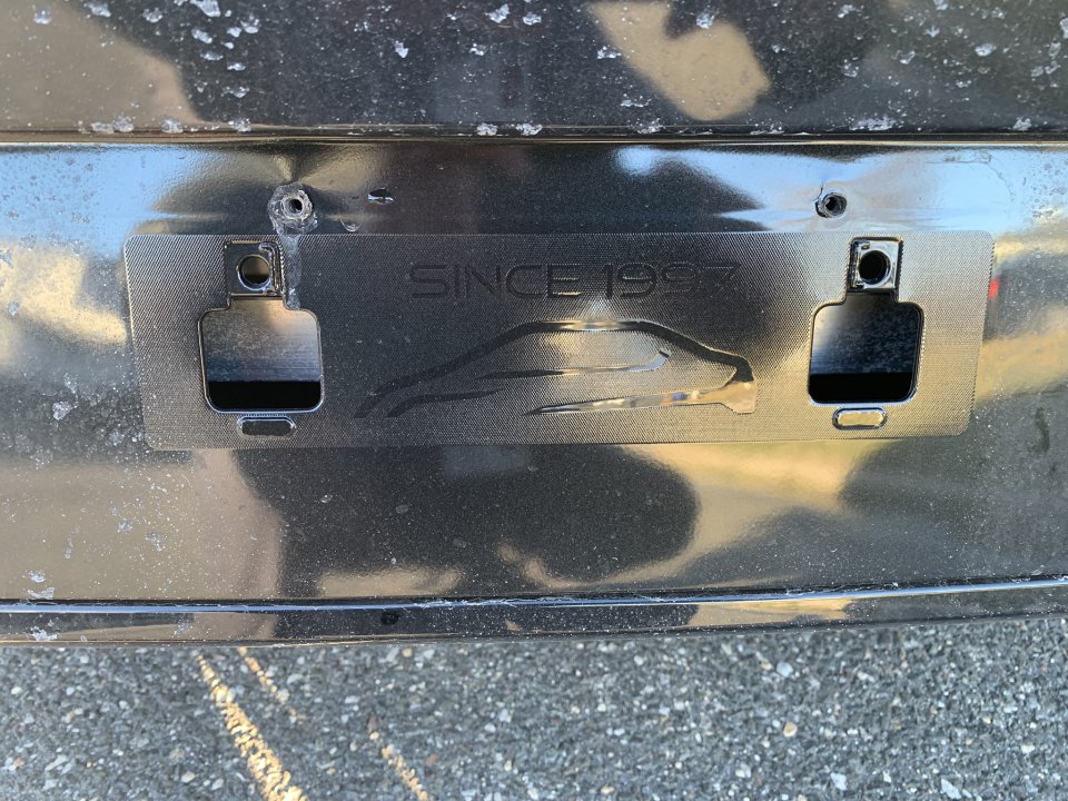

    The back license plate area seems to come with two holes that are JDM standard, with smaller dimples above that line up with US license plate hole dimensions. Those dimples for for self-driving screws.
    I asked the dealer not to drill into the bumper and instead bought a JDM to USDM license plate adapter kit from Amazon. It works but the pre-existing holes were way too big for the screws that came with the kit. I had assumed the screws would fit in the pre-existing holes, but ended up having to use a nut on the other side. It works, but doesn't seem to be very elegant.
    How else have people attached their rear license plate without drilling extra holes into the bumper? Any special adapters you used?

    You can see the two oversized JDM holes in these pictures, with the two US standard holes drilled by the dealer above them.

    I hate to be bloody honest but I would just drill it and stop worrying about the holes I’ll never see again in this lifetime.

    That sounds like a step down: previous gens have correctly located holes with weld-nuts, for supplied stainless-steel machine screws, in a recessed zone of the hatch.

    I'm probably going to let the dealer put in the self-tapping screws, but when I get home I'll redrill the holes, paint the bare metal edges, and put in nutserts/rivet nuts with stainless bolts in a standard Toyota size.

    My 2010 had the captive nuts on the back, but one broke free a few years back while changing plates. I got the rivet nut tool to fix it, and at least now I'll finally be able to get a little more value from a rather expensive tool. lol

    Those holes are actually nuts; so, using the correct nut should be the way to go.
