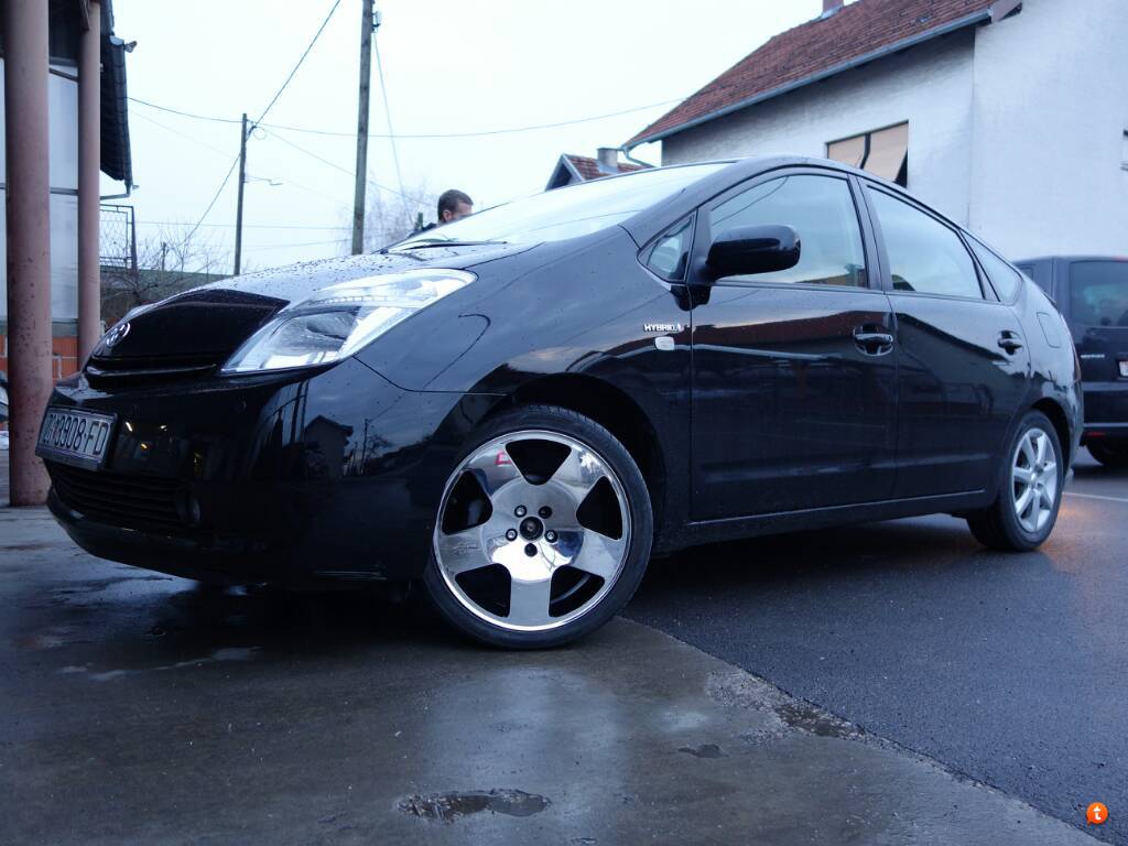

    Testing waters. How do you like polished Audi TT / S3 wheels on black Prius? Got to have it or make it stop?
    Specs: 17x7.5" ET32
    Rims are very light weight.
    Tires will be 215/45/17.
    H&r lowering springs are also in plan.

    They are one of my favourite OE VAG wheel, but the car needs to be real low to pull them off
    Looking forward to seeing it lower on all 4

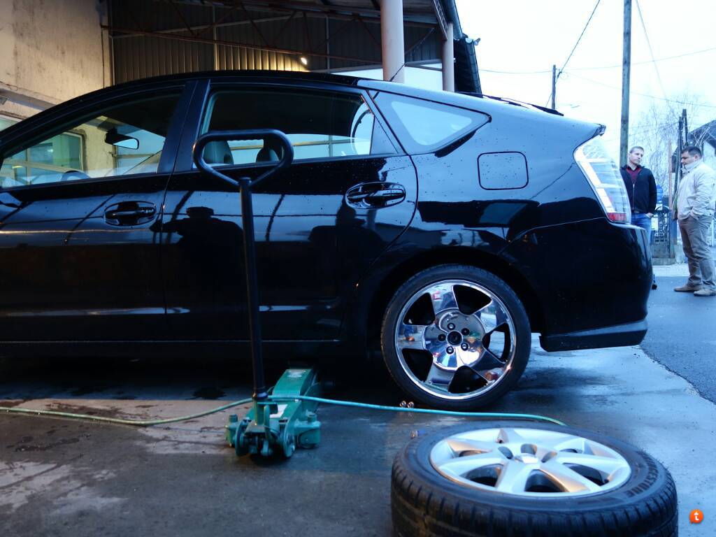

    the krauts tend to use spherical seat lug bolts; good luck finding lug nuts to fit those wheels. if they're anything like Mercedes wheels, they are heavy, easily bent, and over priced. definitely look way better than the oe wheels though...

    Tnx for mentioning the lug nuts. I will use generic ones and machine them to fit the spherical seats on wheels.

    They look well. If it was dropped by about 30-35mm, it would look the business!

    machine those yourself?

    No, tire shop prepared it for me.

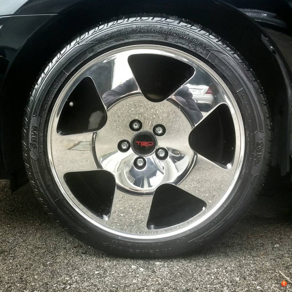

    I know both are 5x100 and the offset is ok, any issues with the difference in centre bore?
  14. ZaX
    ZaX Junior Member
    Aug 23, 2013
    Sesvete, Grad Zagreb, Croatia
    Yes. Toyota CB is 54mm and Audi is 57mm so we machined centering rings.
