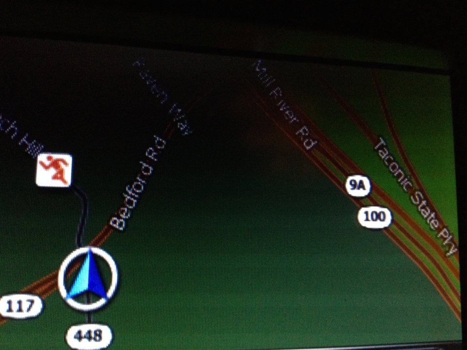

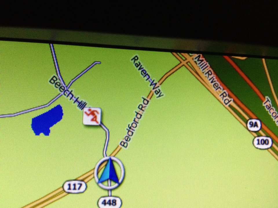

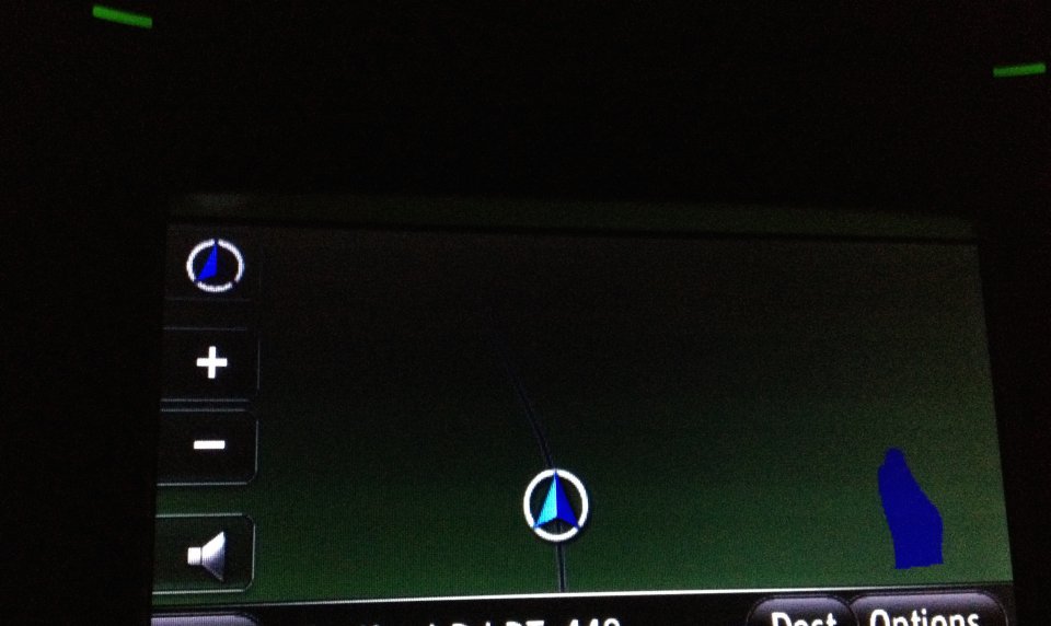

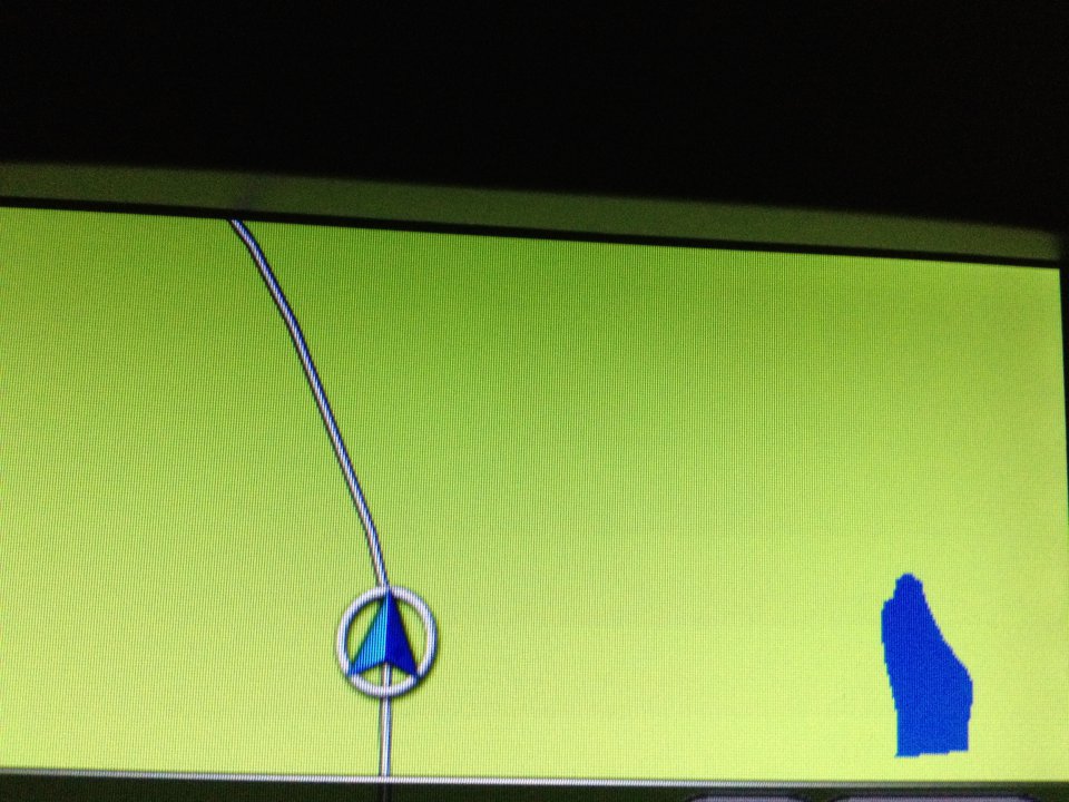

    I have 2012 Prius v. One February night, while I was driving the highway, the GPS system turned to the night mode (auto setting). After a while, the screen got so dark, all I could see was the arrow (your car). I could take a couple of pictures of the screen.
    It was useless as I could not see roads. I brought the car to the Toyota Service, and unlucky me, I got a really bad service rep. To make a long story short, it took him 5 mos to get the replacement part (screen). When I finally went to the appointment to get the new screen installed, the guy was gone. Luckily, he was replaced by a really competent service rep. He got the part within one week, and the new screen was installed.
    However, the GPS did the same thing even that night. He got dimmed so dark in the night mode that the screen basically got all black except for the car icon. I also noticed that I could not switch the map to the music by pressing the button. I could do that before. Now it does not - sometime it does. So when I shuffle the music, and wanted to know the name of the music, I cannot.
    I brought my car back to the service again, and showed the service rep the photos and the screen of the night mode. It is dark and the writing become so small and grey, I could not read them. But the Toyota service think it is the way it is supposed to. I also showed him the inability of switching from map to the music screen.
    They tested the system, software, and everything turned out ok. I am uploading 2 sets of photos - one with Auto day/night mode (night) which is bright and easy to see, and one with the night mode screen that is just too dark to see but Toyota says that it is what it is supposed to. It has been such a long time since I had the normal night mode that I forgot what it looked like. But I do remember that I had no problem reading the map at night.
    So the Service rep will call Toyota tomorrow to see if there has been the similar problems before.
    Does your night mode look like the bright one or the dark one?

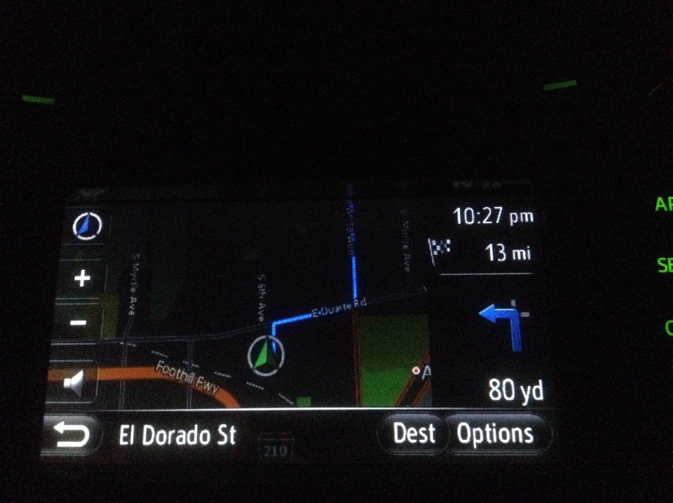

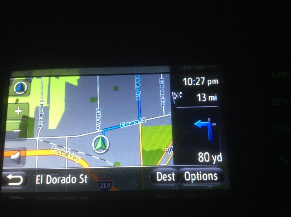

    Here's what my display looks like.....
    Auto mode GPS display, headlights switched off at night,
    Auto mode GPS display at night, headlights in auto. (Too dark and illegible)
    Curious to hear if the 25k mile threshold has something to do with this.
    Please check your systems and post!
