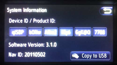

    You should find it at Setup→General→Down arrow→System information

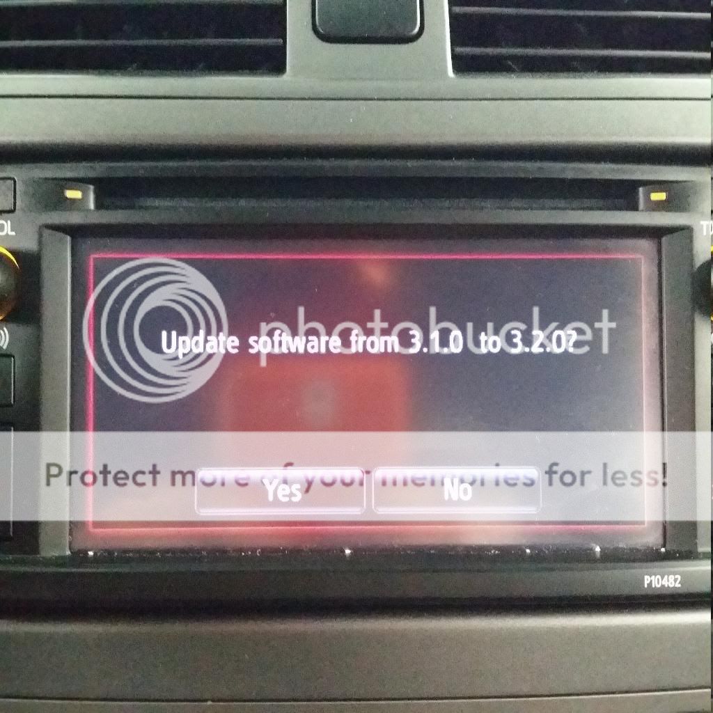

  13. Zephyr7
    Zephyr7 Member
    Nov 12, 2012
    301
    link is on the 1st post by TS.

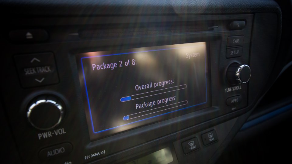

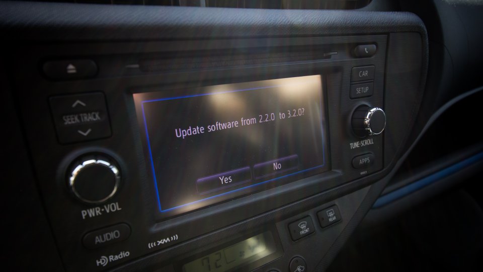

    I updated mine to 3.2 just now. It was pretty easy. Not too many changes that I noticed, but it seems snappier in regards to interface responsiveness.
    Here's the instructions from the Toyota Nation post:
    Entune 3.1.0 update how to/ download link - Toyota Nation Forum : Toyota Car and Truck Forums

    Here's a screenshot showing Entune 3.1.0 - it should be the same on the Three and the Four:
