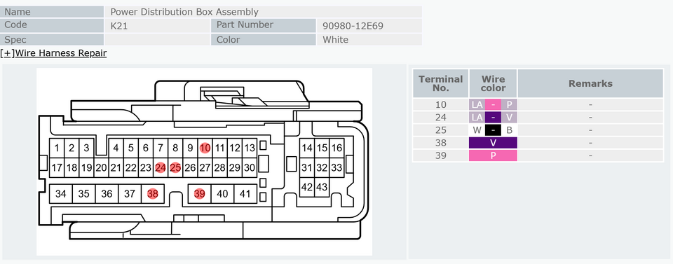

    @Hammersmith I pulled the trigger on a pair of mirrors from JP. I'm combing through this thread for the wires I'll need to tap for the turn signals and to make the folding function work.
    Are there any wires in the footwell I can tap instead of doing into the dash to connect the folding mirrors?
    Are the signals on the side mirrors only for turn signals, unlike previous models where they also had white lights when the headlights were on?
  17. Hammersmith
    Hammersmith Senior Member
    Jul 26, 2021
    2,449
    2,511
    North Dakota - USA
    2023 Prius
    Limited AWD-e
    Only for turn signals; no white.

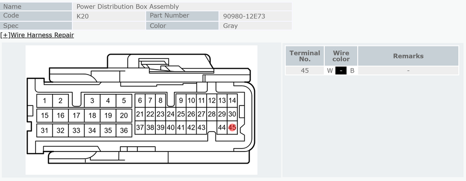

    If you want to enable the power folding mirror function, you have to add wires to the PDBA(the interior fuse panel). I think you can do that without pulling the dash, but it's probably going to be difficult to access the connectors to add the wires. (You're not splicing into existing wires, you're adding completely new wires to the plastic connector that plugs into the PDBA).
    If all you want to do is enable the turn signals, that's quite a bit easier. You can tap into the wires that run to the rear light assemblies and get the signals from there. Both run along the driver door sill. You'll have to pull apart the wire bundle a bit to find the correct wires, and it might take a bit of trial and error if there are multiple wires with the same color.
    The wire for the LH rear turn signal is yellow, and the RH is sky blue. They run direct from the PDBA to a connector in the rear of the car, so you'll have to tap into them along the way. But if you're already at the PDBA to do the folding mirror, a better choice for the turn signal would be a violet(LH) and a pink(RH) wire on another PDBA connector.
    PDBA
    K21
    38 - Violet (LH Turn)
    39 - Pink (RH Turn)
    10 - Lavender/Pink (Mirror Reverse) - new wire
    24 - Lavender/Violet (Mirror Forward) - new wire
    25 - White/Black (Mirror Forward Ground) - new wire?
    K20
    45 - White/Black (Mirror Reverse Ground) - new wire?
    (I honestly can't remember if I added the two grounds. I sure hope I did or at least checked that they were present. Everything works, so I guess I must have done it right. <shrugs shoulders> )
    For the folding mirror function, you'll also need the replacement power window/mirror switch for the driver's door. The car will auto fold without it, but you won't have any way to manually control the folding or turn the auto folding off(outside of a scantool). You can buy the correct one from Toyota USA at an outrageous price, or buy a much, much, much cheaper one from Toyota Japan that will work and look identical. The only problem with the Japan one will be the front power window switches will be reversed(because it's meant for a RHD car). If you're ok with that quirk, it will save you about $400-$600(depending on where you'd buy the US switch from).
    I can give more info, but I don't want to overload you in a single post.
    #97 Hammersmith, May 19, 2025
  18. jtchinoy
    jtchinoy Member
    Jan 26, 2019
    40
    Hayward, California
    2024 Prius
    ----USA----
    Thanks for all of that! Will the motor wires be spliced together to go into those individual connectors?
    I'm looking at the RHD window controls. Can I just pop out the portion for the mirror controls and insert that into my existing LHD window controller? Or is it soldered onto a single PCB along with the window controls?
