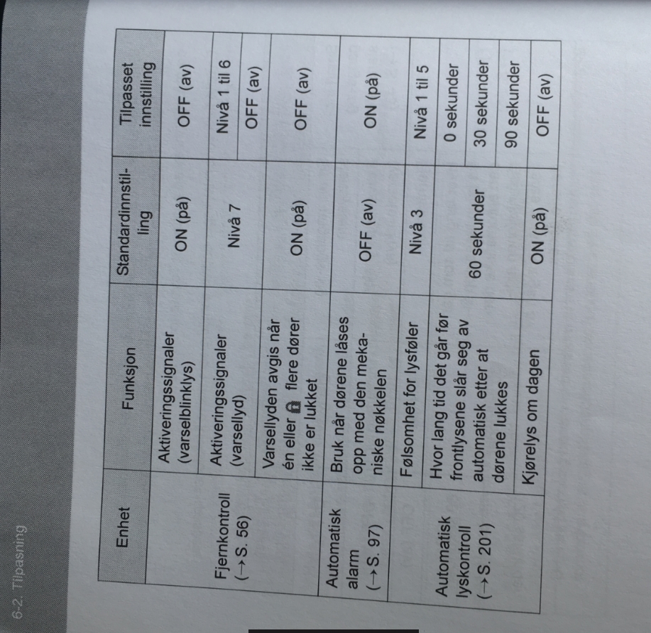

  6. MagnusAG99
    MagnusAG99 Senior Member
    Feb 21, 2017
    673
    521
    Norway
    it says in my instruction manual that its two options, auto on all the time, or auto on at night. But then the question is... will the parking lights turn on when headlights turn off... (bottom sentence), i guess i just need to ask toyota. i was gonna ask them to turn on the beeping when the car locks and unlocks anyways.[​IMG]
