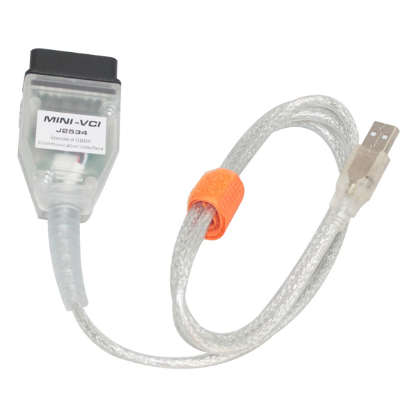

  9. Former Member 68813
    Oct 3, 2010
    3,524
    983
    US
    I had to change the setting about the auto recirc when AC on via TIS. The default is very annoying feature for some of us who like fresh air.
  10. Tropicseed
    Tropicseed New Member
    Jan 23, 2014
    What's TIS? I looked through Carista's settings, there wasn't anything relevant I could find there.
  11. Tropicseed
    Jan 23, 2014
    Posted to soon! As usual google is my friend. TIS = Technical Information System. Everything you might want to know about Toyotas, evidently much of it available only if you're in the biz.
    I'll ask the dealer about it next time I go for service.
  12. Former Member 68813
    Oct 3, 2010
    3,524
    983
    US
    "unofficial" ones available at about $30.
